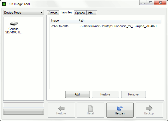

Procedure using USB Image Tool
- Download and install the latest version of USB Image Tool.
- Insert your card into the card reader, the card reader into your USB port, and check which drive letter it has been assigned.
- Run USB Image Tool (your computer may ask you to agree to run the program - click Yes).
- From the top left pull-down menu, choose Device mode.
- In the left panel choose your SD card.
[WARNING] Double-check your card's drive letter! Choosing the wrong drive will likely result in data loss or even worse harm to your computer.
- Choose the Favorites tab.
- Click the Add button and browse to the RuneAudio image file. You may also choose to use the still-compressed file. Simply click the drop down menu near the bottom of the browse screen, choose Compressed (gzip) image files or All Files and choose which image you wish to flash.
- In the Favorites screen, click to highlight the image you wish to flash and then click Restore. The write may take a while, so don't panic.
- When write has completed, close the program, and properly eject your drive.
- You are now ready to plug your SD card into your device. Easy, right?

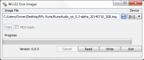

Procedure using Win32DiskWriter
- Download and install the latest version of Win32DiskImager.
- Run Win32DiskWriter (your computer may ask you to agree to run the program - click Yes).
- Click the folder icon and browse to your RuneOS image file.
- Under Device choose your SD card from the drop-down menu.
- Click Write. The write may take a while, so don't panic.
