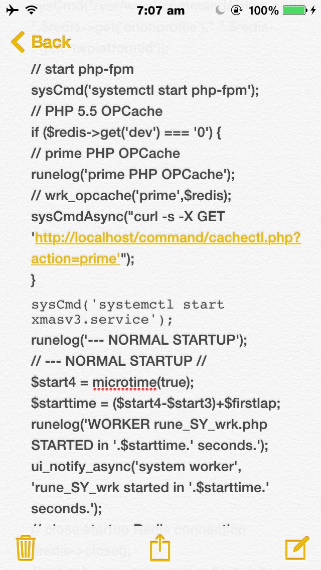

Had time to pop on the RPi now, added that line to /srv/http/command/rune_SY_wrk
worked perfectly the first time then after that it won't start playing again...
Can't get this one figured!

having problems to start playing music automatically after reboot/power down.
made a service like show in this thread (and the other one on the forum), tried editing rune_SY_wrk,...
even dit a git-pull.
no go.
Think this is something essential for headless players without any buttons...
Don't want to pick up my phone/tablet to start my last playlist.
any help?
EDIT:
Finally succeeded by adding a sleep command...
would be nice if 'start playing on boot' would be an option in the gui...
