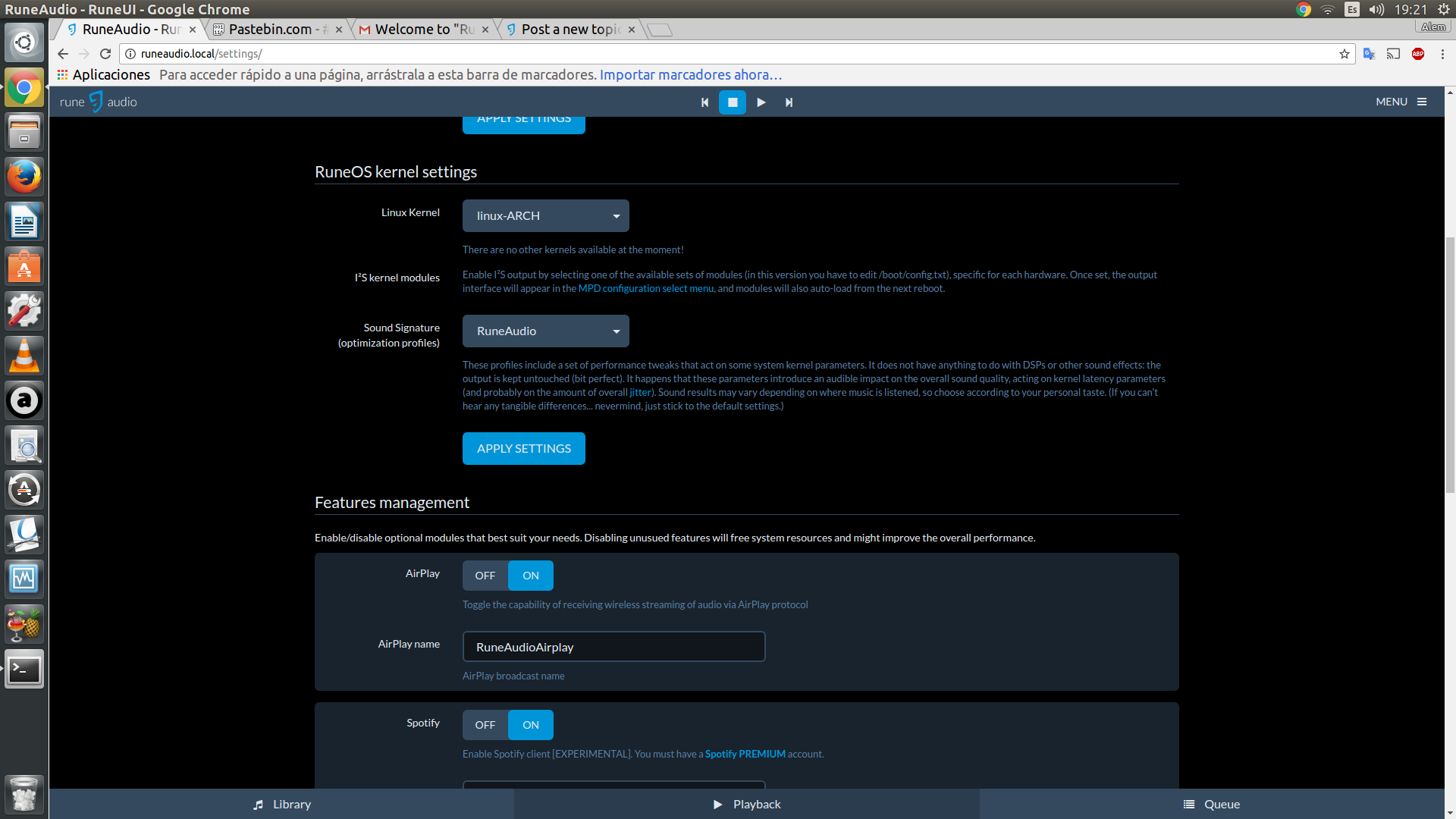

And a snapshot of the settings. Is that ARCH kernel the correct one :lol: :lol: ?

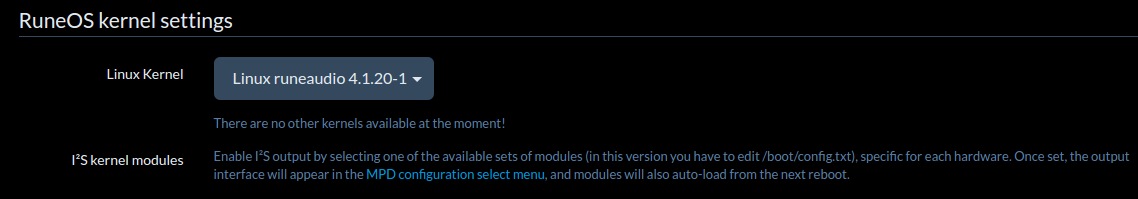

Here is what my MPD config looks like. I'm running Linux runeaudio 4.1.20-1 kernel. I don't think I changed this. This is on a Rpi2. Not sure if it matters. I did ssh into my RP and update the config file to:

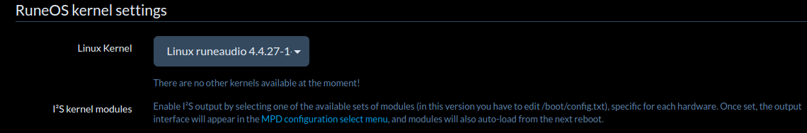

Postby truckinve » 19 Nov 2016, 22:00

Postby surfninja » 19 Nov 2016, 23:26
here is what I have. Also, my debug says:
###### System info ######
Linux version 4.4.27-1-ARCH (builduser@leming) (gcc version 6.2.1 20160830 (GCC) ) #1 SMP Sun Oct 23 17:26:59 MDT 2016

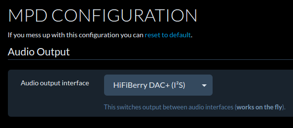

Postby surfninja » 20 Nov 2016, 01:07
