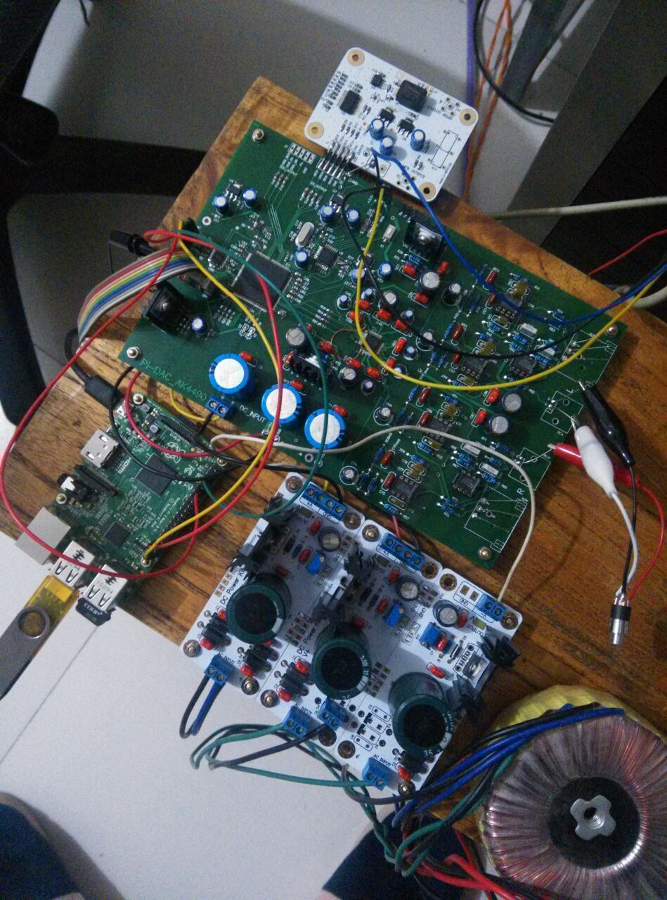

PCM I2s and DSD share a straight line communication. I began to realize that the technology is no problem _ ^ ^
I build a basic DAC AKM4490 chip.
I think he might be the best run of the chip in the hifiberry DAC
But I have a problem right now...
Akm4490 has been able to sing wonderful music, but he has not found in the MPD settings - > output character.
I think it needs power and I2C support, but I don't know what to do....
Andre
my diy dac
