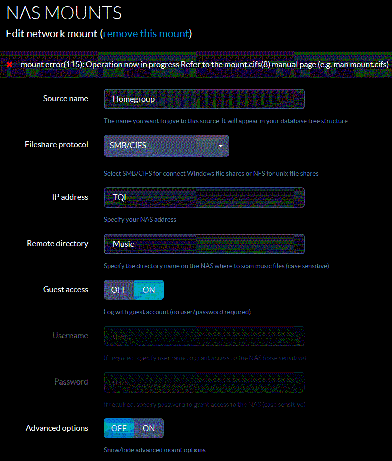

I'm trying to access music on my Windows 8.1 PC across my LAN.
I am getting the error:
mount error(115): Operation now in progress Refer to the mount.cifs(8) manual page (e.g. man mount.cifs)
The files on the homegroup can be seen by another PC on the homegroup so I'm satisfied that the homegroup itself is working.

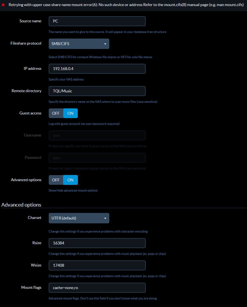

I have tried entering a specific IP address instead of the homegroup name but this gave a different error:-
Retrying with upper case share name mount error(6): No such device or address Refer to the mount.cifs(8) manual page (e.g. man mount.cifs)
I have tried to enter an Administrator/Guest ID and password, using the Windows Homegroup password but that makes no difference.
Runeaudio is working very well if I have my music on a memory stick in the player but it would be great to get this working so I don't need to use memory sticks any more.
Any assistance gratefully appreciated.

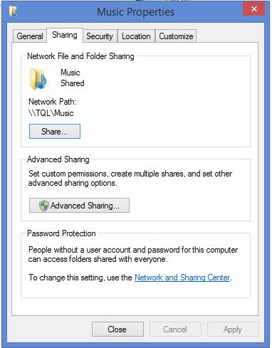

Please see my latest attempt below - I am now getting a different error when I use the explicit IP address (see below). I've also included an image of my Windows share details.

Postby hondagx35 » 07 Jun 2015, 23:25
try "Music" as remote directory.
Re: Add a mount - Windows share problem
Postby hondagx35 » 07 Jun 2015, 23:47
Postby Discovery » 08 Jun 2015, 00:00
Finally cracked it!
Users/Trevor/Music was required for the directory. :-)
