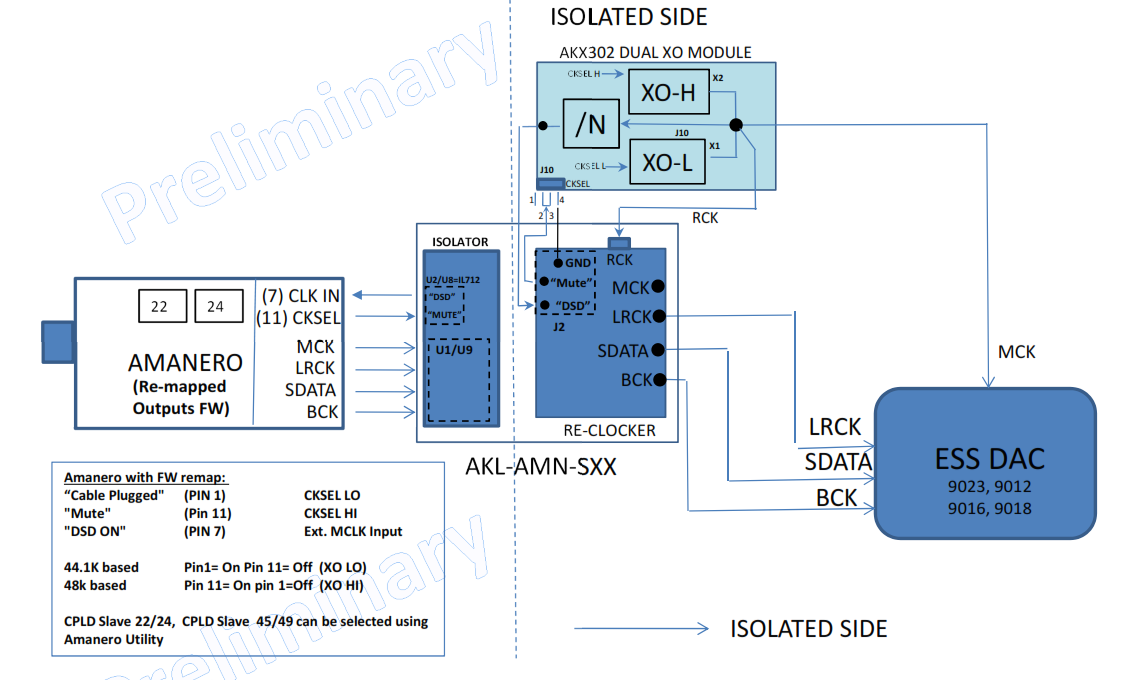

When it comes to the technical discussion.
I fully agree with Stino that adding better clocks improves the sound quality very much but what I am trying to say in my earlier post is that for the first time one is able to make a fully synchronous setup with SOC and DAC.
Something like the following setup but with a bbb instead for the amanero usb/I2S.
That is what I am listening for now and I have to tell you that it is maybe the best sound I ever had in 30 years.
I think it could be very inovative to integrate mieros exelent work in your firmware. Maybe with a "botic settings" section one can change the driver settings.
