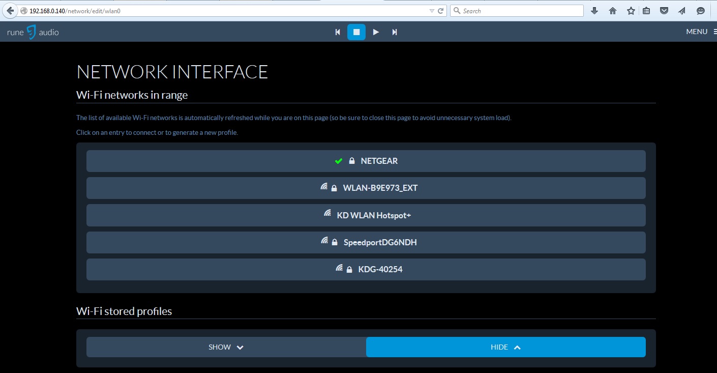

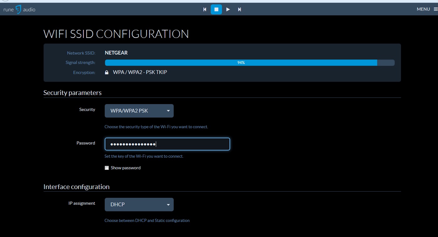

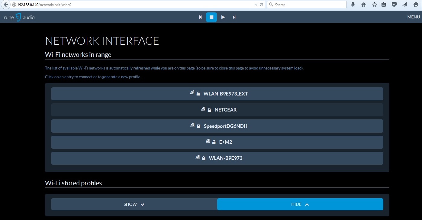

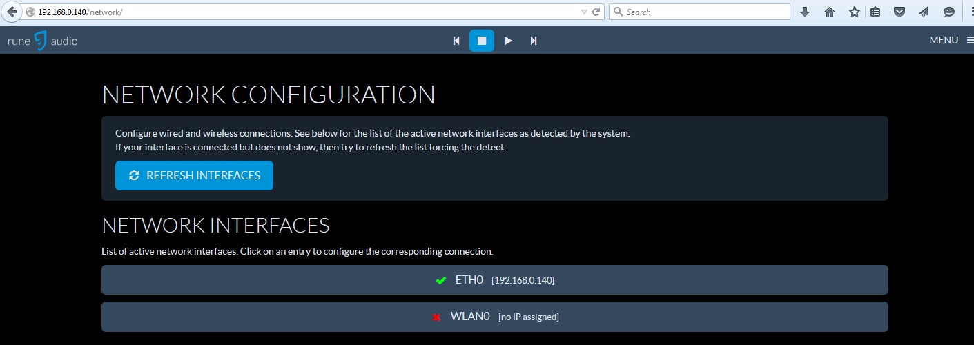

Postby kayjays3 » 13 Aug 2015, 18:17
Thanks for the response. Reflashed the SD and updated as suggested, it has changed things a little but now I'm seeing similar problems to those others have reported.
Rebooted after the update, ethernet cable and usb wifi dongle both in, eth0 is connected. Network scan finds my SSID, select and enter password, hit connect, no connect and it then returns to the network scan. Refresh interfaces, no connect. Reboot, wlan0 not connected, refresh interfaces and it connects. I can then ping from the laptop running the UI. Shutdown, power off, remove ethernet, power on and no connection - router doesn't show a link. Shutdown and reconnect ethernet, UI shows eth0 and wlan0 both not connected although one clearly is, refresh interfaces and eth0 reports connected, wlan0 is not. After that reboots and restarts don't restore wlan0 connection.
So progress of sorts but no fix.
