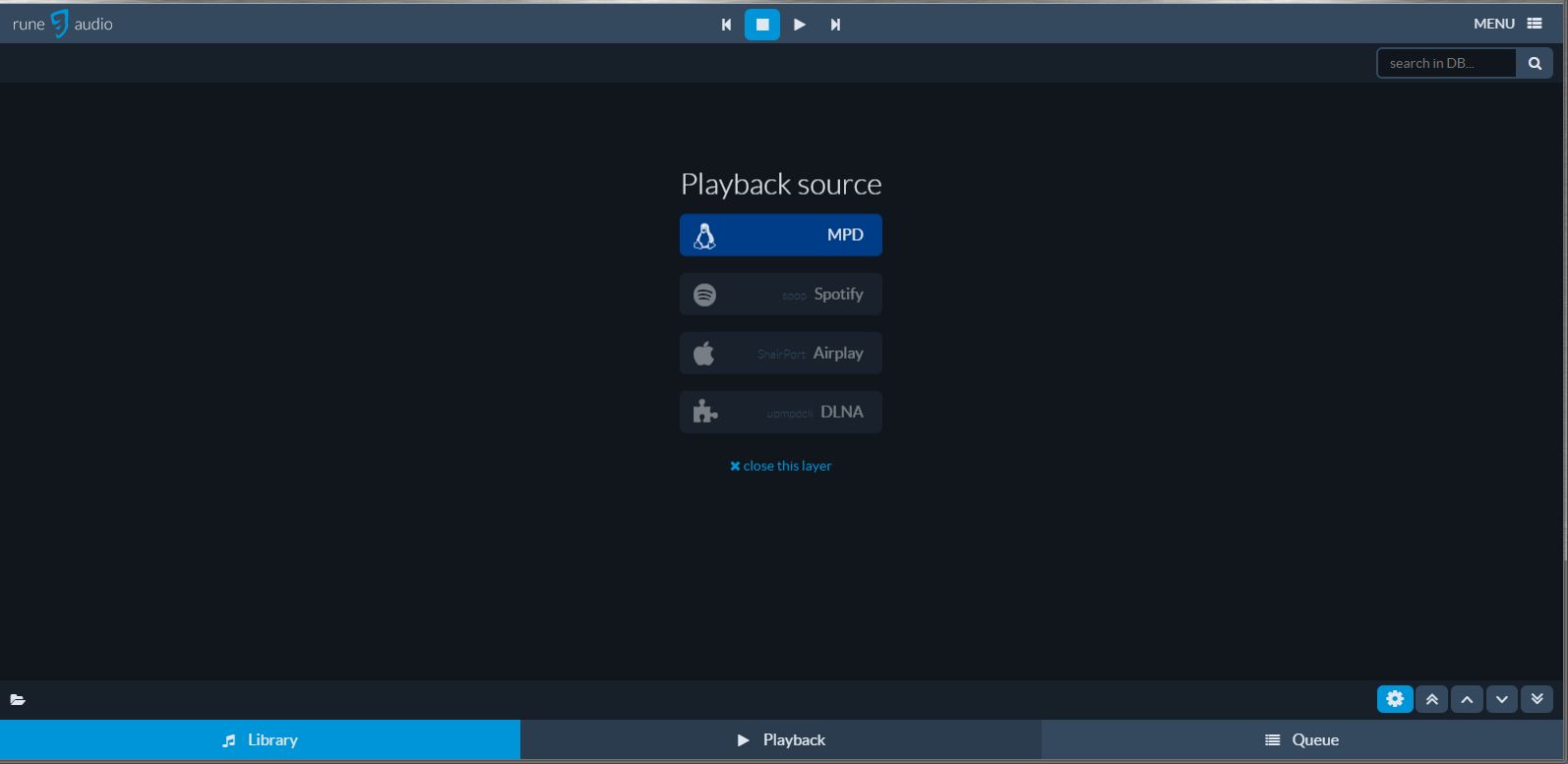

2) I cannot 'see' my upnp server. When I go to the The graphic is greyed out when I try to select it as a 'source'. In order to use it in volumio, I had to enable library view, but this is a bit different and I did not see that option.

We implemented the UPnP/DLNA renderer in RuneAudio using upmpdcli. That's not used to browse UPnP/DLNA resources on a server of your local network, but to play streams sent from there by a UPnP/DLNA control point. Please take a look at the to understand better how this works.

Thanks for the quick reply. I fixed my post with the debug (sorry). I am better informed on how the render point works, thanks. I also understand why the radio pls works the way it does. As it is, I can now listen to radio and send music to it as a renderer. The remaining bits are to get it to see my music library on my UPnP/DLNA server and get the hardware volume working. I will dig into the hardware volume a bit more after the holiday (Thanksgiving), but need a bit of guidance as to how to see my server. I'll wait patiently.
