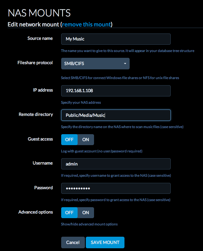

Postby skrodahl » 12 Sep 2014, 08:51
Hi Matt,
Are you using a host name or the IP address directly for your mount?
The error message "Could not resolve address" would indicate that you are using a host name. You didn't provide the new assigned IP address, so I'm using the first one in this example to show you how you can mount your storage:
Screen Shot 2014-09-12 at 09.43.51.png (71.35 KiB) Viewed 3971 times
The "Source Name" is just what you'd like to call your source. I called it "My Music" in this example, but you could use whatever you'd like.
Then I put in the IP address, and the path to your music collection.
If you look further down on that picture, there is a setting called "Guest Access". Set that to "Off" if you have to enter a username/password for your storage. If a username/password is not needed, set it to "On".
There should be no need to play around with the advanced options for now.
-skrodahl

Postby matt » 12 Sep 2014, 09:31
Hi skrodahl, yes thats exactly what I've been doing.
I've just finished pulling all the plugs out of everything on the network, rebooting everything again, rewriting the image to the sd card and trying to mount the mycloud.
Success!! A nice green tick!
Dunno what was wrong, I was beginning to think the mycloud was faulty.
:D
