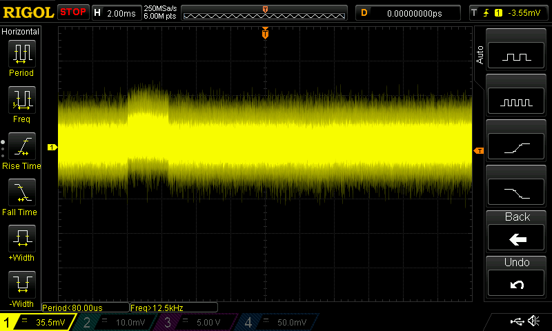

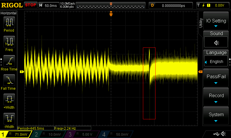

Attached you will find two measurements on my amp's output at 0 hw volume (1) and the other while playing music at a not so loud volume (2).

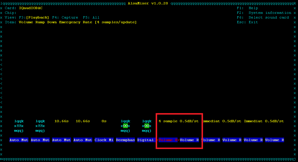

- Second example shows modified ALSA settings. A maximum long ramp down was the only setting that eliminated the pop on files that are directly on PI. All other setting did not produce any difference. Even changing standby settings. So example shows difference between pi local file (no pop) and same file on NAS (pop).

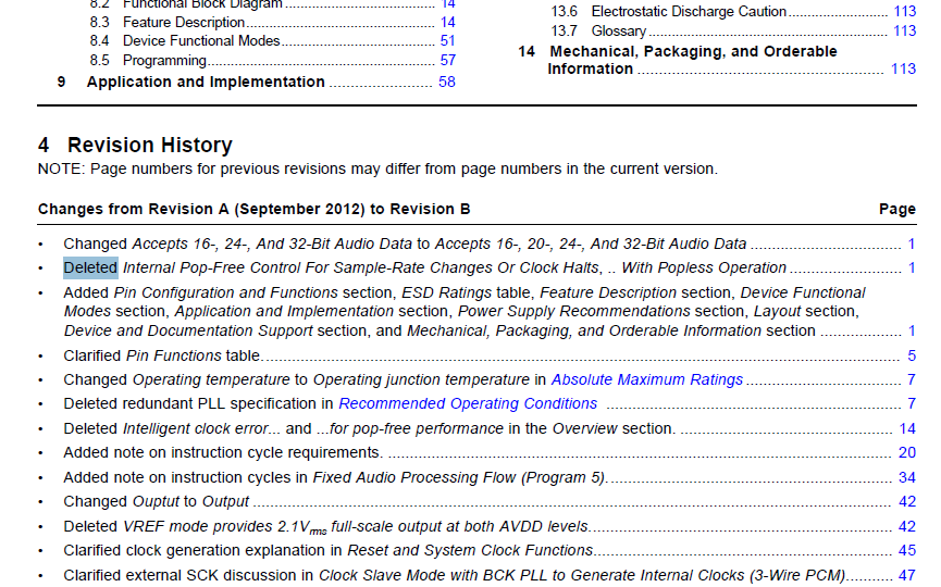

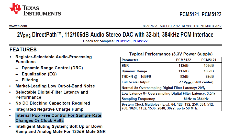

Old datasheets of PCM5122 state on first page as main function: pop-freeness on clock halts or frequency changes:
http://pdf.datasheetcatalog.net/datashe ... cm5122.pdf
This was deleted in the current version Jan 2016:
http://www.ti.com/lit/ds/symlink/pcm5122.pdf
Did TI remove this feature or just don’t want to get vulnerable?
