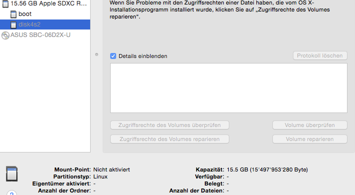

Postby tinue » 02 May 2015, 20:06
The MacOS Disk Utility? It does not know about the ext3 filesystem, and thus can't tell me anything about the partition.
The attached picture is from a Raspbian SD card, but Runeaudio also uses ext3, so I don't think it looks much different there.
Or am I misunderstanding you?
