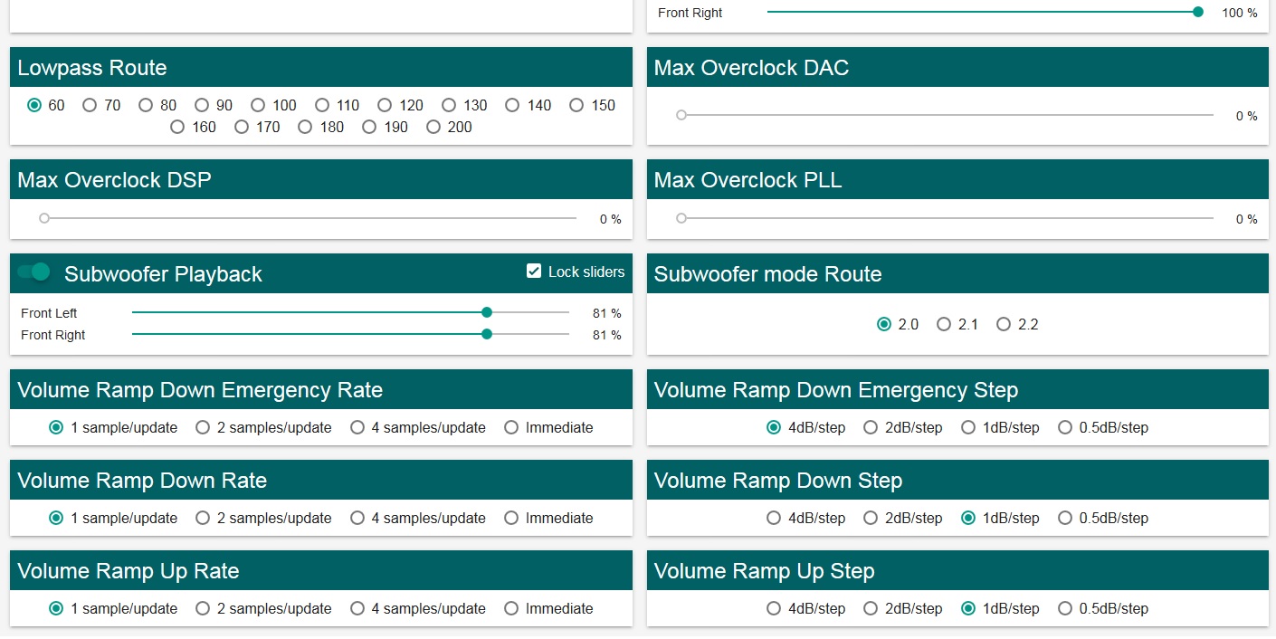

i'm keen on the piano 2.1 but was wondering how difficult it is to change the outputs eg. change from 2.1 to 2.0
Allo claims to have made an app but I can't find any info on it, maybe there is info supplied with the board?
Or is it the purepass process flow that is used to change settings?

I would like to set the Piano DAC 2.1 into the "dual-mono" mode (<- thats not the 2.0 setting within alsamixer)
After researching, it seems that either RuneOS needs an more recent Linux kernel a/o the Piano DAC 2.1 an firmware update by ALLO (!?)
So far, if i try to activate it via SSH shell, it says that the command is unknown..
This example below shows what it should be:
root@x ~# amixer -c 0 sset "Dual Mode" "Dual-Mono"
Simple mixer control 'Dual Mode',0
Capabilities: enum
Items: 'None' 'Dual-Mono' 'Dual-Stereo'
Item0: 'Dual-Mono'
Did anyone try to get the Piano Dac 2.1 running in "Dual Mono" Mode with Runeaudio Beta 04?
Thanks in advance
