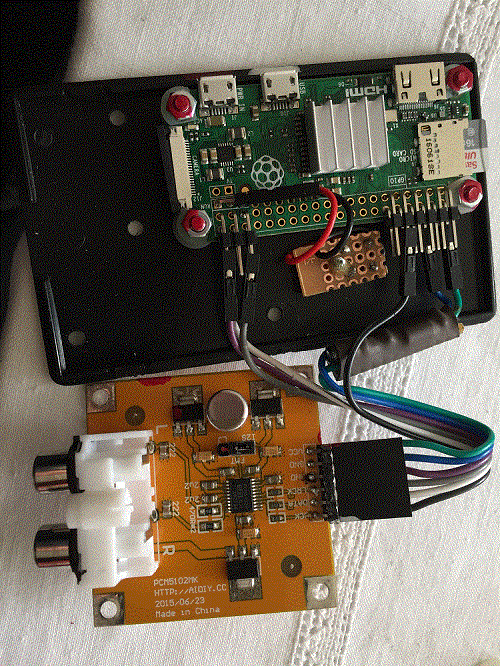

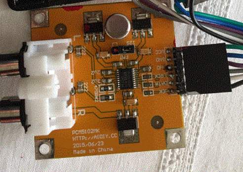

I have your pcm5102 DAC module.
But... I connected BCK lrck data on this module to pi3b + rune0.5bata
He doesn't work. I'm sure the hardware wiring + power supply is correct!
What should the driver of Rune be set to?
Or did I miss something?

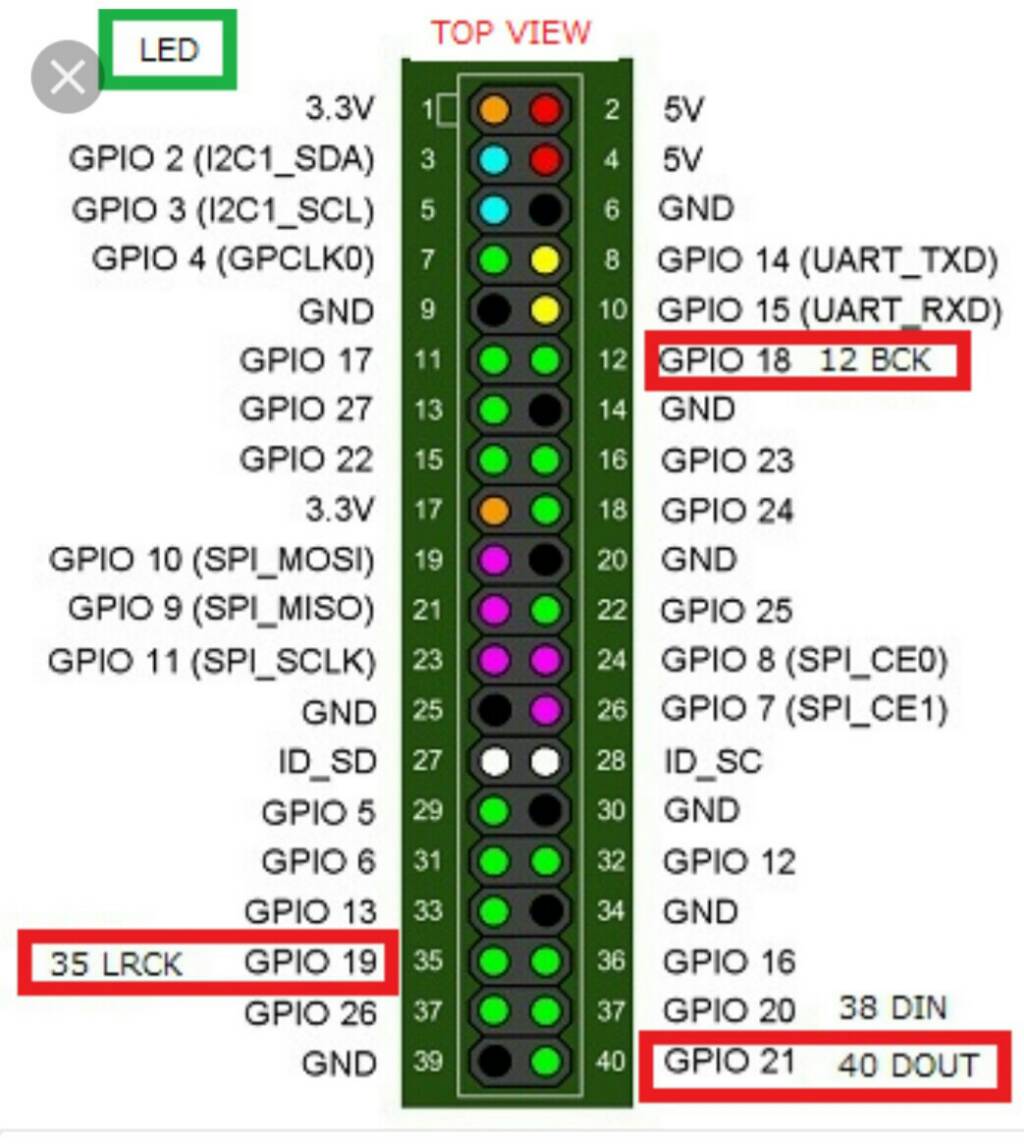

Postby janui » 09 Sep 2019, 17:00
audio gpio.jpg (103.77 KiB) Viewed 4659 times
