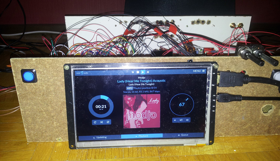

Hi guys,
I just wanted to confirm to everyone that this touch screen is working almost plug-and-play with runeaudio:
https://www.amazon.de/Eleduino-Raspberr ... B01GE2RV7W

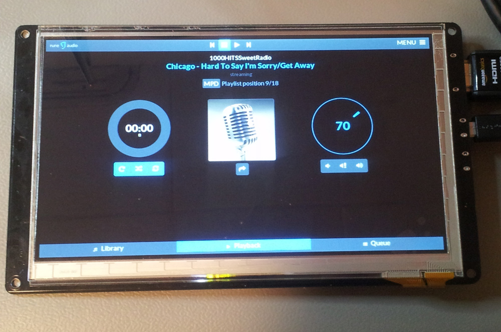

Due to the higher resolution and almost same lcd size everything is a little smaller than on original raspberry touch screen.
But it's touch is very precise so it is perfect for me.
So I could have larger covers in future or use the space for other UI modifications.
The colors are also perfect, not like on my pictures ...
I also tested the official raspberry touch, but I experienced problems switching with the three categories in bottom.
Also that the volume setting wheel was reacting very slowly and setting volume even if i was not touching anymore.
On the Elduino both was gone and I am still wondering why i did'not have to install any touch driver :D
As my Runeproject is proceeding I started with Pi 1 and now I am on Pi 3B and still not finished ... :roll:

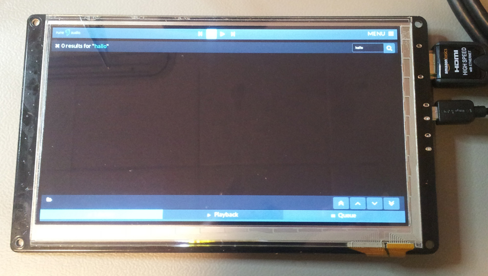

Edit config.txt and add e.g. after (#config_hdmi_boost=4):
hdmi_group=2
hmdi_mode=1
hdmi_mode=87
hdmi_cvt 1024 600 60

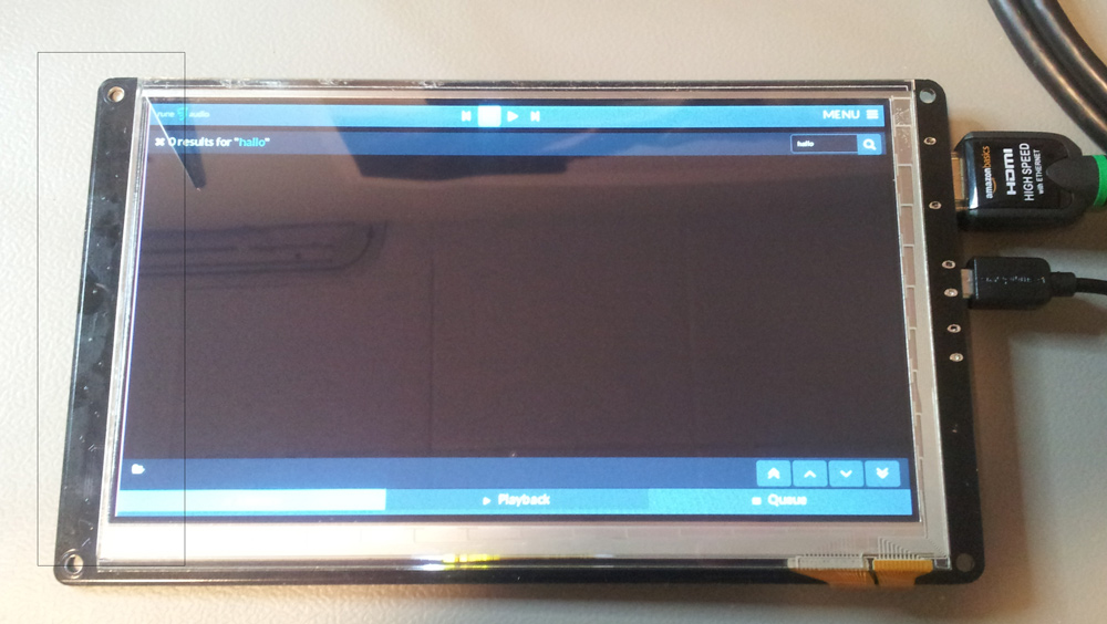

Just be careful that you comment this out by putting a # in front:
#hdmi_drive=2
Otherwise you will have a purple vertical bar of 2-3 pixels on the left side.
Found this out by trial and error ...
Same here I guess: http://forum.kodi.tv/showthread.php?tid=282146
In my case I also put a left overscan of 4 pixel because on the left there was some glue between touch and lcd
Don't set too much, because it will relativly strech the touch on 4/1024 percentage ...
overscan_left 4
