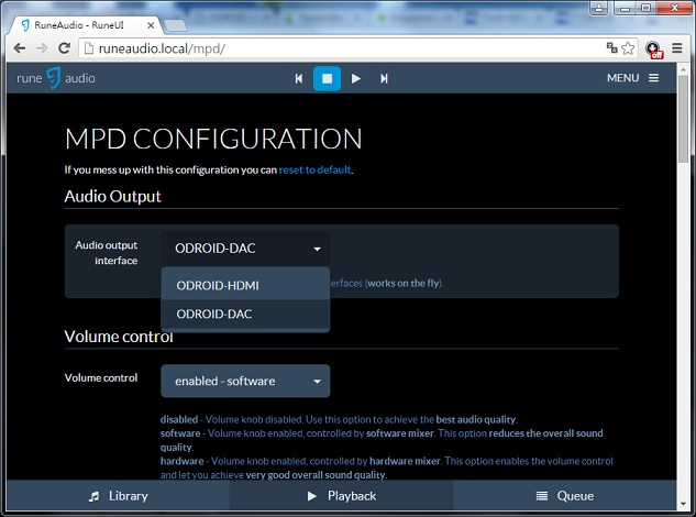

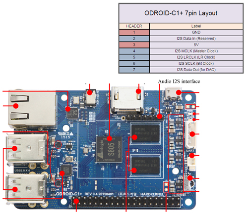

By default, RuneAudio for Odroid C1+ 0.3beta do not enable I2S DAC driver.
Under Audio output interface of MPD configuration, you cannot chance the default output interface – ODROID HDMI.
To enable I2S DAC driver, you need to edit the boot configuration file: $ nano /boot/boot.ini
Scroll down until reaching this part:
# PCM5102 audio DAC Enable/Disable
# Uncomment the line below to __ENABLE__ AudioDAC(PCM5102)
#setenv enabledac “enabledac”
Remove the hash like this:
Save your changes with “Ctrl-x + y + ENTER” and reboot.
