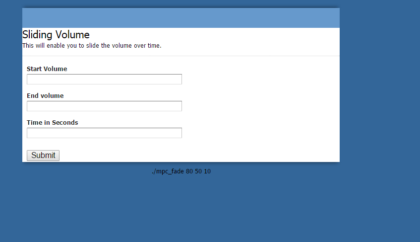

Ok, after doing some coding, I came up with the following (Now in Beta 1):
https://www.dropbox.com/s/4t6pcyez0r4oo ... 1.tar?dl=0
NOTE1: Install BC (with "pacman -S bc") before starting
NOTE: MPC and BC values hardcoded.
extract the file in /var/www then open your browser with:
http://<your rune ip>/slide/slide.php
It will bring up a page with values you have to enter. It is very self explanatory :) this is still very early in the coding and I need to make it Mobile Friendly. What it will do is slide the volume from a start value to an end value over time.
Future release:
1. Read the current value (volume) and make it the start value. - Done
2. Make the code Mobile Friendly.
3. Integrate into Rune as an add-on. (Will need big help here :) )
4. Only allow numeric values. - Done
