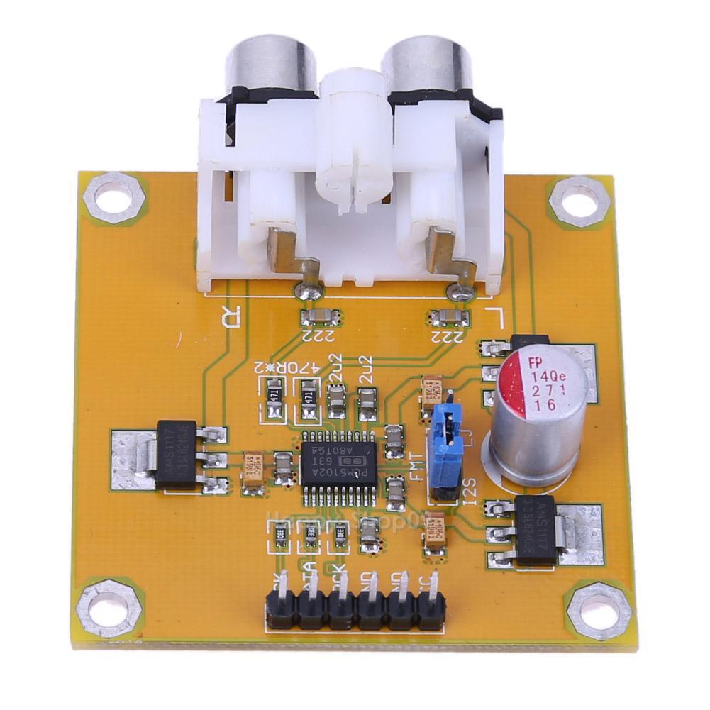

This is my first forum post and my first Rune Audio build.
PCM5102A I2S DAC (yellow PCB) commonly sold on Ebay. It has 3 AMS117-3.3 low dropout voltage regulators. There is no model number nor manufacture name on the PCB.
Currently powered with +5V from the RPi B+. Sounds great, much better than I would have thought a $5.66 usd DAC should. All credit to Ti for producing the PCM5102A and to the developers of Rune Audio.
RaspberryPi B+
RuneAudio_rpi_0.3-beta_20141029_2GB.img
Linux version 3.12.26-1-ARCH
I²S kernel module HiFiBerry DAC
Tentoes
Raspberry Pi B+ running Runeaudio 0.3b
Ti PCM5102A I2S DAC feeding LJM L20SE class AB 100WPC DIY 'Dumpster Build' power amp and Energy ESM-2 2-way bass reflex speakers.
