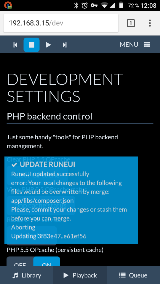

4.) RuneAudio APP doesn`t find my device => also thread from this forum but i get this Failure from the web UI
4.a see my screenshot... ideas?

Hi Janui - thanks for reply but it doesn't work...
when i type in git stash i get
warning: CRLF will be replaced by LF in app/libs/composer.json.
The file will have its original line endings in your working directory.
Saved working directory and index state WIP on master: 3f83e47 added default files for libao and shairport
HEAD is now at 3f83e47 added default files for libao and shairport
Developer Mode is on correct?

Postby janui » 05 Jul 2017, 20:32
I got a similar message from git stash, but the git pull worked fine after.
What did the git pull do?
If all else fails see this post raspberry-pi-zero-support-in-0-4-t3711-70.html#p20577, I use this image om my B+.
