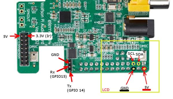

BTW, today I managed to set up LIRC and the same TSOP IR sensor and a remote control I have at hand fairly quickly in Volumio (although not without hiccups!) - took me some revisiting of web resources regarding Lirc...
What matters is that now I'm sure that the IR receiver (sensor) works, and that the wiring is OK :)
(Last year I managed to burn one IR sensor by wiring it to RasPi incorrectly - luckily I damaged only the IR sensor, and not the RasPi!)
I'd much prefer to use RuneAudio: the UI is much quicker, the OS boots very fast, and I generally prefer it to Volumio.... But, I'm at a total loss in Arch Linux architecture and config files. :(
So, if anyone can shed any light on how to go about setting up IR sensor using Lirc in RuneAudio, I'd appreciate it very much...
