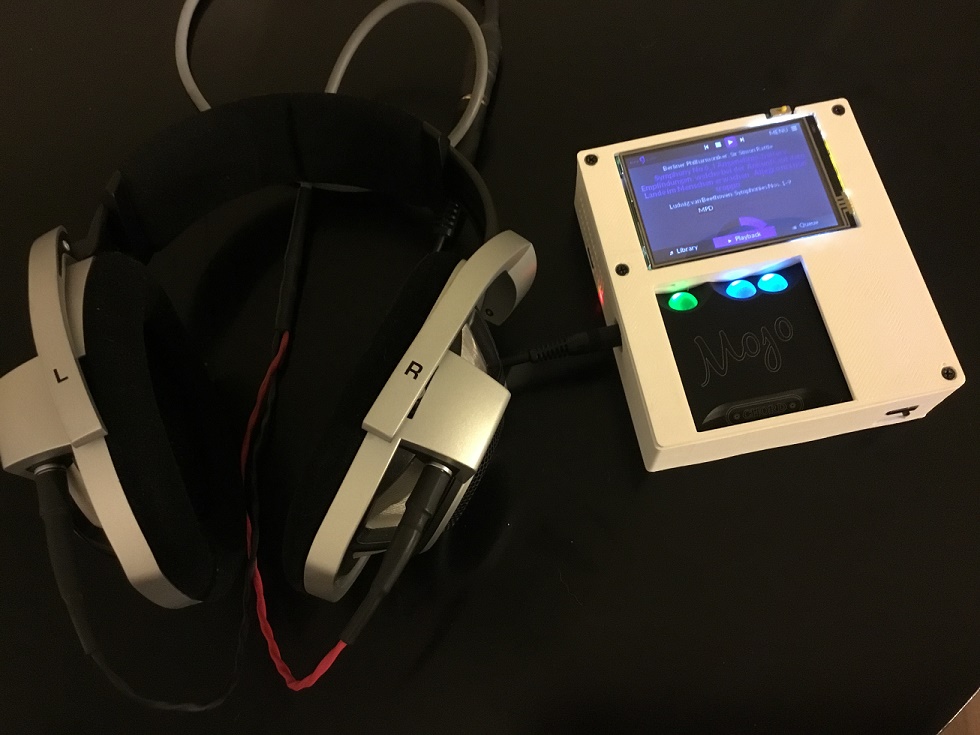

Here is what the enclosure looks like now:
2016-06-01 19.31.13.jpg (180.75 KiB) Viewed 4904 times
It is basically a 3D Printed enclosure for a Raspberry Pi 3, a Chord Mojo portable DAC, 4 SD cards in SD Card readers attached via USB, a 5300 mAh Lithium battery, and a Tontec 3.5" Screen. The Chord Mojo is attached to the Pi via USB. The purpose is to hide all the cabling between the storage, source, battery, and DAC. I'm using the Chord Mojo because it provides tremendous sound quality and is able to drive full-size headphones.

The mousepad looks like the right solution if yu want something more than one or two buttons, and the enclosure looks really nice! Why don't you post some pics in the DIY section, perhaps it will inspire other people to give it a try.
