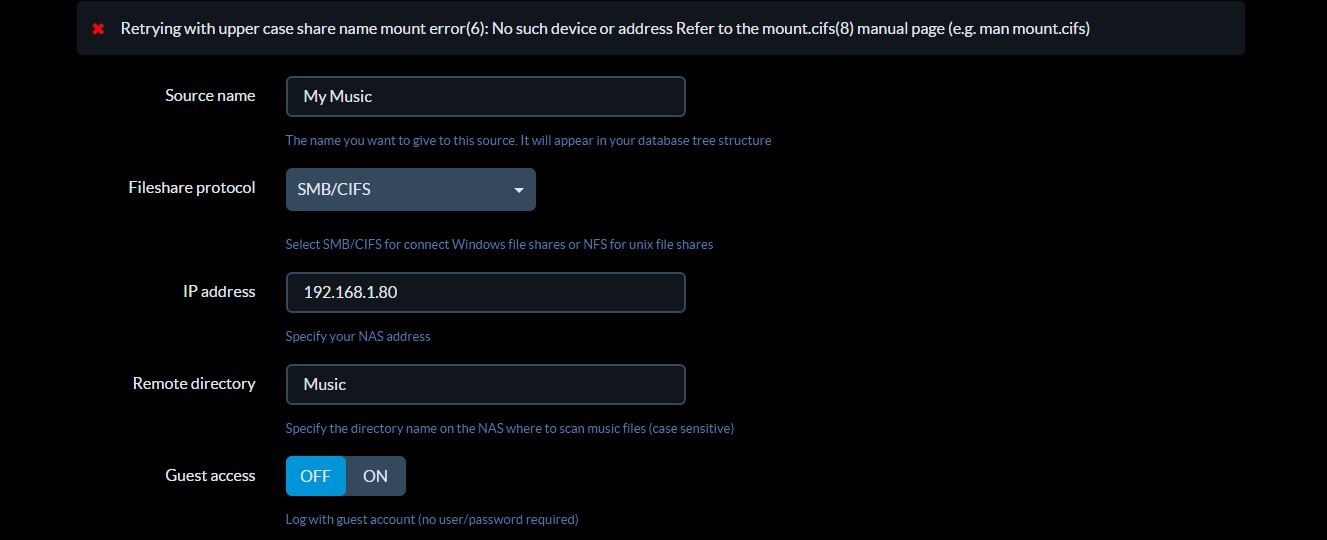

Postby Soundmachinery » 06 Dec 2015, 14:12
I have done that and get this error
Retrying with upper case share name mount error(6): No such device or address Refer to the mount.cifs(8) manual page (e.g. man mount.cifs)
I have entered the ip address as indicated on my windows laptop

Postby Discovery » 06 Dec 2015, 14:29
Correct NAS set-up is not usually achieved first time but it's usually straightforward to resolve and worth it once working. 8-)
Can you show a screen shot of the NAS settings you have entered? Windows Snipping Tool is useful for this, in case it helps. Otherwise, just specify the values entered for each field on the NAS entry screen so we can see what it's trying to use.

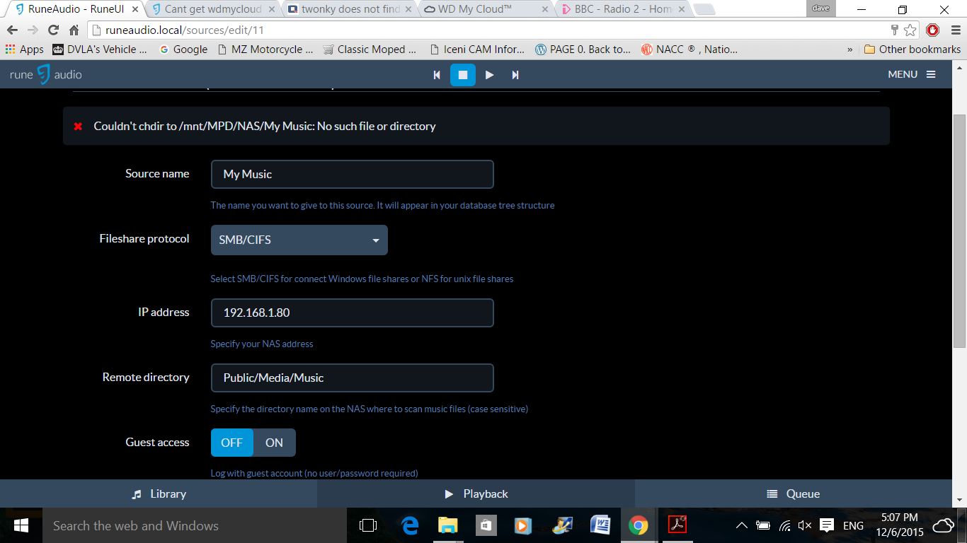

Postby Soundmachinery » 06 Dec 2015, 16:23
Hopefully attached is a screenshot of my configuration

Postby Soundmachinery » 06 Dec 2015, 18:06
Latest attempt at connection to my WD Mycloud. I can connect all my mobile devices to the Mycloud but not the Pi

Postby Discovery » 06 Dec 2015, 18:25
Does your WDCloud require password access? If so, specify your ID and pwd in the Guest access section.
Other than that, the last thing to get right is usually the sub-directory definition. Try experimenting with different combinations once you've seen how Windows Explorer categorises the sub-directory. As examples, to connect to my music on my PC I had to use 'Users/Trevor/Music' (without the single quotes) but on my later NAS I just used 'music' (without the single quotes).

Postby Soundmachinery » 06 Dec 2015, 18:46
There is no password and the tree is Public/Shared Music/Mp3 but it still doesn't find it!

Postby Discovery » 06 Dec 2015, 19:01
The last screen print says 'No such file or directory'. You're getting close...
Try different combinations, e.g. removing 'Public/', etc. Or adding '/mp3'.
