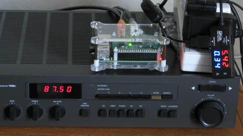

1: I have been monitoring the power on a Pi 2 with a HiFiBerry DAC+ using a small inline USB multimeter. It uses around 2 watts steady state, so 2W x 24 hr/day x 30 days/month, is about 1.4 KW-hr/month, or about $2/month (in the US). Muting the output makes little or no difference, most of that power is consumed by the Pi and the dongles, not the dac. So, it stays on most of the time.
2: I have been considering a hard-wired volume control using an encoder, which can be used with any dac. The problem is the software interface, not the dac hardware. This takes it out of range for newbies, unless you already know how to interface the encoder to a Pi. If IQAudio has included software to do this in one of the Distros they offer on their web site (there are several), I would say go for it. On the other hand, you could use a separate passive or active volume control on the output of the dac. The good ones are pricey, but the results are usually very good if you know how to use them.
3: Nothing is preventing using a radio Tuner in parallel with a Pi/DAC combo. Some tuners were integrated with a preamp, so they have inputs that can be used for any external source. You can connect the output of your dac to one of the several preamp inputs, and you are good to go. You can buy good used preamp/tuner combos on ebay, or complete receivers with plenty of extra inputs, for well under $100.
The dac becomes one of the sources you can switch using the front panel of the preamp. This is exactly how one of my two Pi's is hooked up, to a spare input on an old NAD receiver.
Pi 2, HiFiBerry DAC+, USB inline multimeter on the right, used NAD 7020e Receiver.

I did my measurements on the DAC+ and the DIGI+, adding an amp would increase the power. I leave the Pi w. DAC+ on, and I turn the receiver in the pic on and off as I need it. You can turn in on and off with the Pi, if you want. That way it only turns on when you play music.
The receiver in the pic must be 25 years old. It is an integrated AM/FM tuner, preamp, and power amplifier, in one case.
