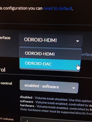

Postby smallfat » 02 Apr 2016, 23:49
檔案 3-4-2016 06 51 59s.jpg (67.09 KiB) Viewed 28744 times

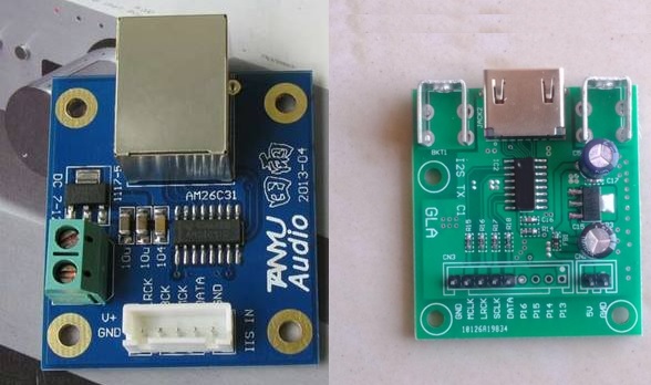

Postby smallfat » 04 Apr 2016, 20:28
As our understanding, I2S signal cannot be transmit too long.
There are some proprietary transmission standard, no matter from famous brand or DIY market,
enable I2S signal transmit longer.
I use a conversion board which convert I2S signal to their proprietary standard.
Signal convert back to I2S at my DAC.
So I need generic I2S signal like ODROID's I2S out.
Best Regards
Michael

Postby smallfat » 05 Apr 2016, 01:36
Actually, on my ODROID C1 plus case,
when I select ODROID DAC, I get I2S signal.
Via the conversion board, signal pass to my DAC. Sound very well. Nearly 60-70% performance compare with my CDM3 CD player.
If I provide better quality of power, performance
even better.
Best Regards
Michael
