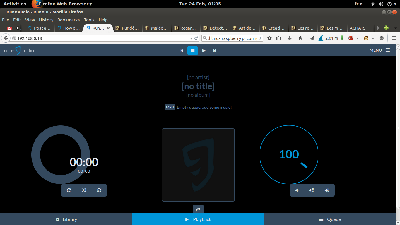

Well, I finally found some time to check it out
I've set another runeaudio in parallel to my hi-fi, then I have a full dev system
I've replaced the www with git version of it, as said in the post
First, the UI "playback" is 'broken', meaning things are not aligned properly (see the attached screenshot
Note that on the very same browser, another runeaudio v0.3 (production, not dev) is working fine
Second, I did not managed to set up the wifi using RuneUI
But that was the occasin to learn some arch stuff, like ip link, ip addr, wifi-menu and netctl
Is it supposed to work, and there's something wrong with my setup ? Or there's some work there, and I can try to understand/fix this ?

Postby bastienauneau » 24 Feb 2015, 12:34
just did clear cache, as explained here:
https://support.mozilla.org/en-US/kb/ho ... efox-cache
But it still show the same "kind of shifted" GUI

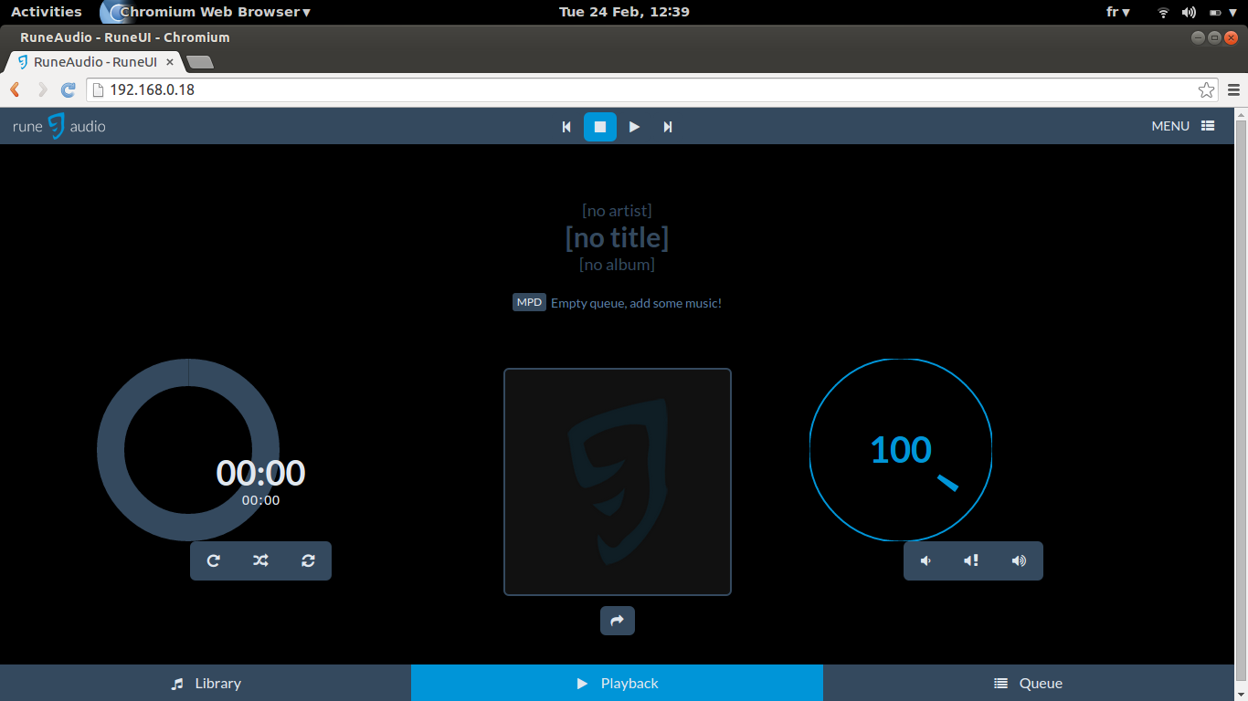

Postby bastienauneau » 24 Feb 2015, 12:41
same with chrome
My system is :
RuneOs: 0.3-beta (build 20141029)
RuneUI: 1.3
Hw-env: RaspberryPi
current www replaced by :
git clone -b dev https://github.com/RuneAudio/RuneUI.git/ /var/www
archlinux updated to latest : pacman -Syu

Postby bastienauneau » 24 Feb 2015, 12:52
looks like we got the same idea
clearing OPcache did not help
disabling the OPcache made RuneUI behaving weird
restarting and trying more in this direction
runeUI says : the loading layer (spinning arrow) points to a socket arrow
bastienauneau
Posts: 17
Joined: 16 Jan 2015, 15:18
Re: I want to help but don't know how ))
Postby bastienauneau » 24 Feb 2015, 15:20
Strange things happened, until I redone the flash, the update and git clone
And ... restarted properly before playing around with cache
So that was it, my bad
