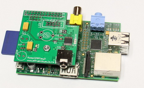

Yes, HiFiBerry is good compromise for best sound vs price :) I made DAC board myself also based on PCM5102A DAC chip (this DAC have good feature, can genarate MCLK inside of it) and we don't need to use external +-Vsupp for OP on output, this simplify electronic design. In difference of HiFiBery on our board we also have LCD/Buttons connectors.
After few months of listening this small board I must say that solution is very promising.
Picture of our device:
RaspyI2SModule
This board is made for local DIY audio community in Serbia :)
If you want to implement full function of this device DAC+LCD+BUTTONS I can help in testing purposes, or something else in hardware domain.
P.S. I also tested couple of another DACs (WM8740, WM8727, ES9023, AK4396) with our PIC32 based MCLK generator for best HiFi sound, but this device not-yet ready for publish.

Your board is very interesting too! I personally think that I2S is the way to go on the Raspberry Pi, leaving behind its well-known limitations of the shared Ethernet/USB bus. You are going in the right direction with your work, and we are are interested in supporting I2S DACs in future releases.
