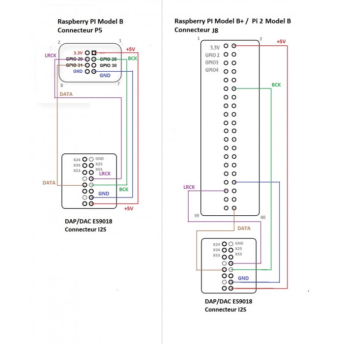

Hello
Anybody knows how to set up parameters for i2s port on Pi model 2B ? My DAC is an external one , Sabre MK2 ES 9018 , directly connected from PCB pins to the Pi ( five pins ) , as suggested from Audiophonique . http://www.audiophonics.fr/fr/dac-diy/a ... -9019.html.
My previous DAC was a HiFiBerry "HAT" module which was quite simple to enable. At this time i haven't found a solution to enable the port , still not available on audio interfaces in RuneAudio. I'm getting crazy !! There are so much options under config.txt on terminal .... What can i do for??

hello Frank
here enclosed the schematic that comes for Sabre Dac ES9018... i connected as suggested by Audiophonique with five pins ( wired connection of course , example to follow is the right one Ri p2 model B
Thank you

Bad news....
The i2S source becomes visible on Runeaudio but a kind of bad noise come out from the right channel mixed with sound ( nothing at all from the left channel )
