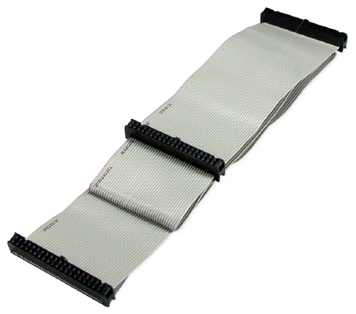

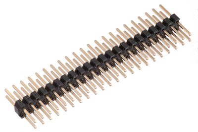

Postby Peter » 08 Apr 2014, 20:21
Why not try one of these to changer header gender? Or am I missing something (as usual)?
