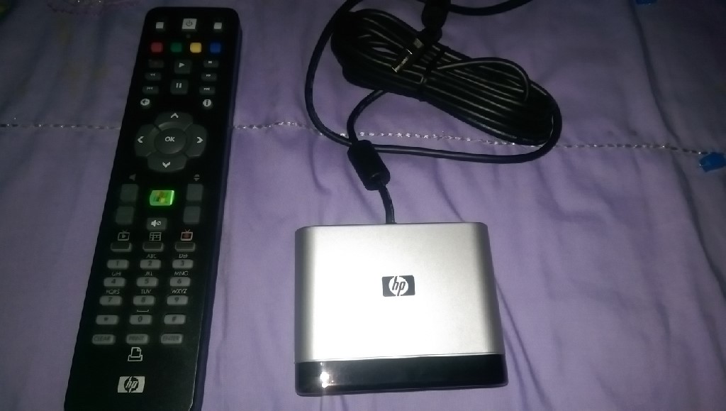

Sorry for the questions but just want to integrate as much as possible into this build in it's prototype state, before I even think about designing a chassis. The project details are on .
I have this:
It is a USB IR Remote and Receiver, I personally think it's THE best media center remote around and I've used loads - ATI's Remote Wonders and numerous ones that come with tv cards and standalone to use with Windows MCE. This beauty came with a HP Expresscard DVB-T Tuner (that in turn came with certain HP Pavilion media laptops and pcs in 2006/07/08) but the remote I've had plugged into my laptop and have used for years without the DVB-T card. The remote is the best feeling remote of any other, excellent quality plastic and buttons, extremely sturdy. And look at the amount of cable the IR receiver comes with!
If anyone wants a MCE remote to use with the computer/pc this is the one to get. Got a second one too and was wondering if it's possible runeaudio can utilise this? If so I can integrate the IR receiver! Doesn't matter about the bulk of the remote functions, just being able to use the play/stop/skip is enough to navigate a playlist when not using the UI via my phone or tablet.
It's nothing too proprietary, in the device manager it's a Microsoft eHome Infrared Transceiver.
Thanks again and sorry to be pestering people on this forum for what may be simple "see it while blind" linux stuff for many of you.

I really like the Logitech Harmony remotes. It lets you have one remote control for everything.
With your favorite remote control, adding an IR-receiver to the Raspberry Pi requires very little magic indeed:
https://learn.adafruit.com/using-an-ir- ... r/overview

Aah yep the Harmony remotes are the holy grail, I don't even compare them to MCE remotes as they're in a different league. Aside from them, I do love the HP as a conventional MCE remote, it's nice to have something that isn't tacky in build quality, and the HP remote just feels brilliant.
Mmmm this is very interesting, I have some IR diodes as well so going to wire upto the GPIO and give it a shot! I'm assuming I'll be able to access the lirc package from the SSH or even just from the PI whilst connected to HDMI screen and KBD?
Think I've also found a lirc config file for this HP remote off the lirc website in their supported remotes directory. But from the instructions you posted off the adafruit site, looks like I'll be able to make my own. Just want a few functions, not the whole remote. Thanks for your knowledge!
