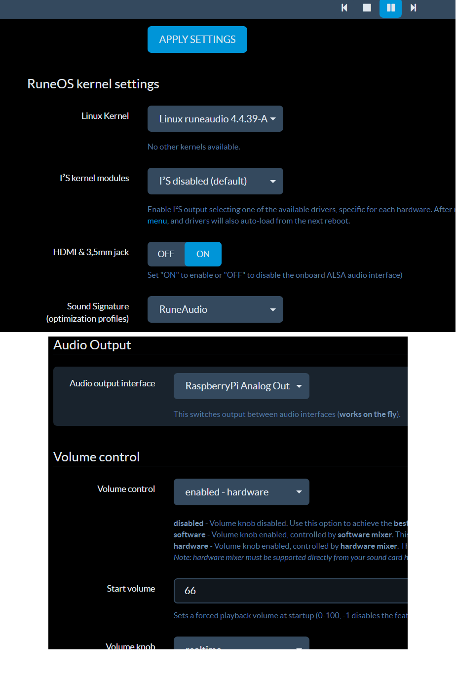

Thanks, I went out this morning and bought a new PI3 Model B as my PI1 could not run new RuneAudio_rpi2_rp3_0.4-beta_20170229_2GB version....
So i see the nice new features, very slick indeed!
However, I have no audio? :(
I am using the analog audio jack, and in settings & MPD its configured like in the attachments..
ANy Ideas?

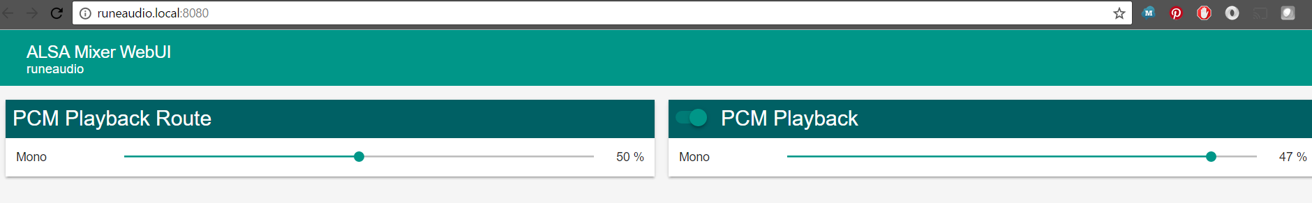

Hey Stephane, thanks for the quick reply!
SO at that url i see the below, and I cannot adjust anything...
robmorin
Joined: 09 Mar 2017, 18:26
Re: Logon authentication for gui?
Postby Stephane » 10 Mar 2017, 19:31
Yes you can ! Try to grab the sliders and push to 100%

Postby robmorin » 10 Mar 2017, 19:48
The first slider does not move and the second when moved does nothing....
