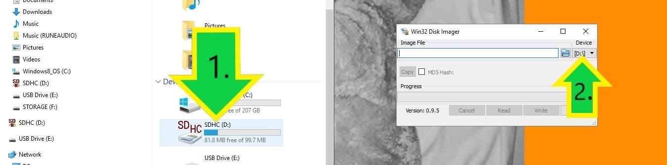

1) Insert SD card and check the drive letter it has been assigned.
2) Select that drive letter from the 'Devices' drop down menu.
Screenshot (1).jpg (62.41 KiB) Viewed 1632 times

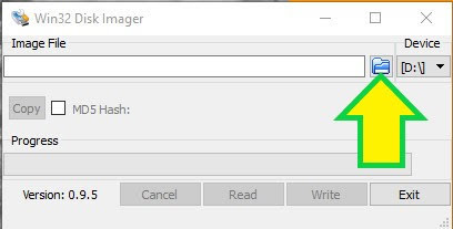

3) Click on the little blue folder.
Screenshot (2).jpg (16.38 KiB) Viewed 1632 times

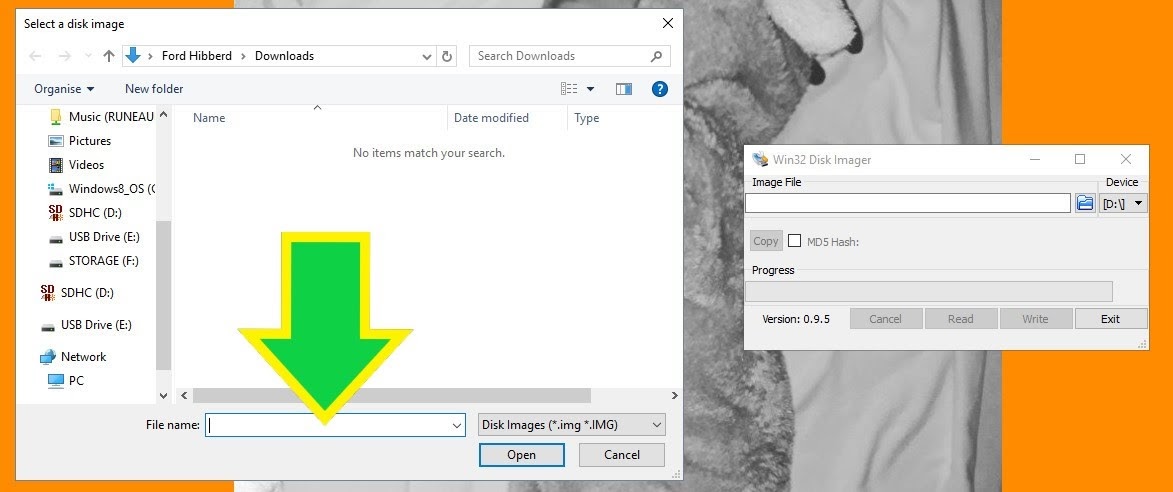

4) If it's easier you can use the 'Downloads' folder for now and then move the file elsewhere later on. Enter a filename in the box indicated by the arrow. Click the 'Open' button.
Screenshot (3).jpg (76.83 KiB) Viewed 1632 times
Something I forgot to mention last time is that the file name must be followed by '.img'. For example, my filename is: RuneMod24-02-2018.img. If you like you can just copy that filename into the box.

2. You need to be 100% sure that D: is your SD card. If it contains the files 'Overlays' and 'Kernel7' then it probably is. But I would check in 'My Computer' anyway.
4. This where you are getting stuck I think. The 'Open' button is perhaps confusing things because you're not really opening anything. Just specifying a filename and location. Here's what to do again (again). Follow this exactly:
- Click little blue folder.
- Specify a location on your PC (if you want, but 'Downloads' is fine for now).
- Type a filename in the box next to the 'Open' button. Or just copy paste this: RuneMod24-02-18.img
- Click 'Open'
The filename and destination you just entered will now appear in Win32DiskImager.

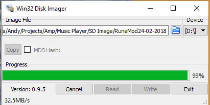

As long as you know that you've got the correct drive letter in 'Devices' and you are happy with the destination and filename of the file, click 'Read'.
That's it. It will take a few minutes, depending on the size of the SD card and how fast your PC is.

This is the first time I have backed-up (or whatever I am doing). The photos are there – thank you. I was confused, but I put in a file name – I was not aware I needed to do this…. Seems like the little green bar is moving to the right. So, I guess it is good…. ha-ha we will see next time….
