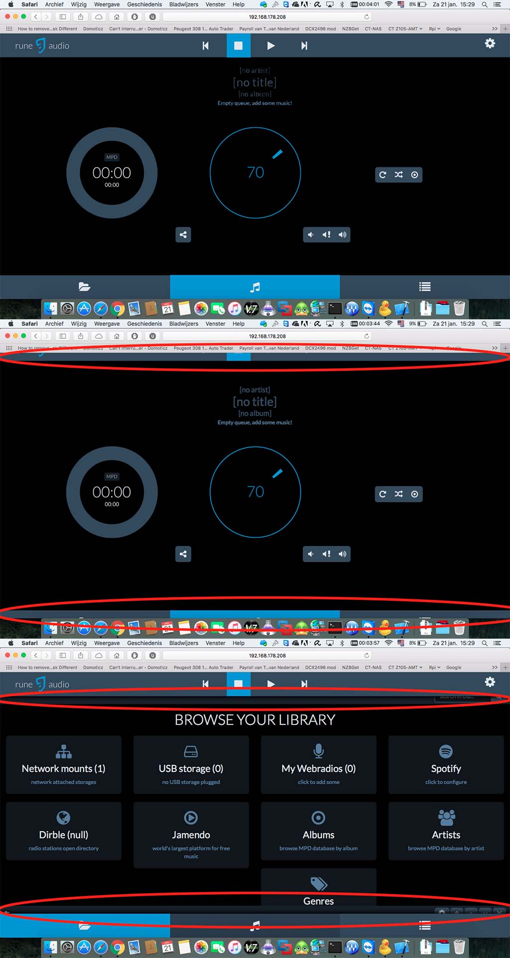

Postby ColinT » 21 Jan 2017, 15:45
Thanks RERN for you help.
i now have a bigger interface, but.... :)
now the middle part is not fitting anymore, how can i adjust it to make it fit?
also the top en bottom menu do not disappear any more.
some screenshots attached

Re: Make buttons larger
Postby rern » 21 Jan 2017, 21:33
middle part
order, -webkit-order (1-6)
top, bottom
top, bottom (px)
Postby ColinT » 22 Jan 2017, 14:34
hello rern,
your solution in custom.js works, thanks.
your solution in custom.css did not work, this only makes the space between the time-knob and the buttons smaller.
is there another option that i can do?
thanks for your help so far :)
Postby rern » 22 Jan 2017, 15:38
display: flex;
flex-flow: row wrap;
#time-knob ------- #coverart ---- #volume-knob
#play-group ---- #share-group --- #vol-group
order: n;
width: n%;
max-width: npx;
each of above flow left to right, wrap to new row on full
The #coverart was hidden so the rest moved up to filled the place instead.
