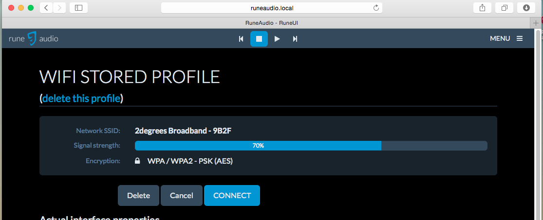

I created a wifi profile and it appears and shows a signal strength and everything but when I go to connect it just reverts back. I will do some screen grabs as well. To show you what I mean.

The screen shot shows that there is a signal when I create a profile, but it doesn't connect at all. and it doesn't appear when I scan for networks.
