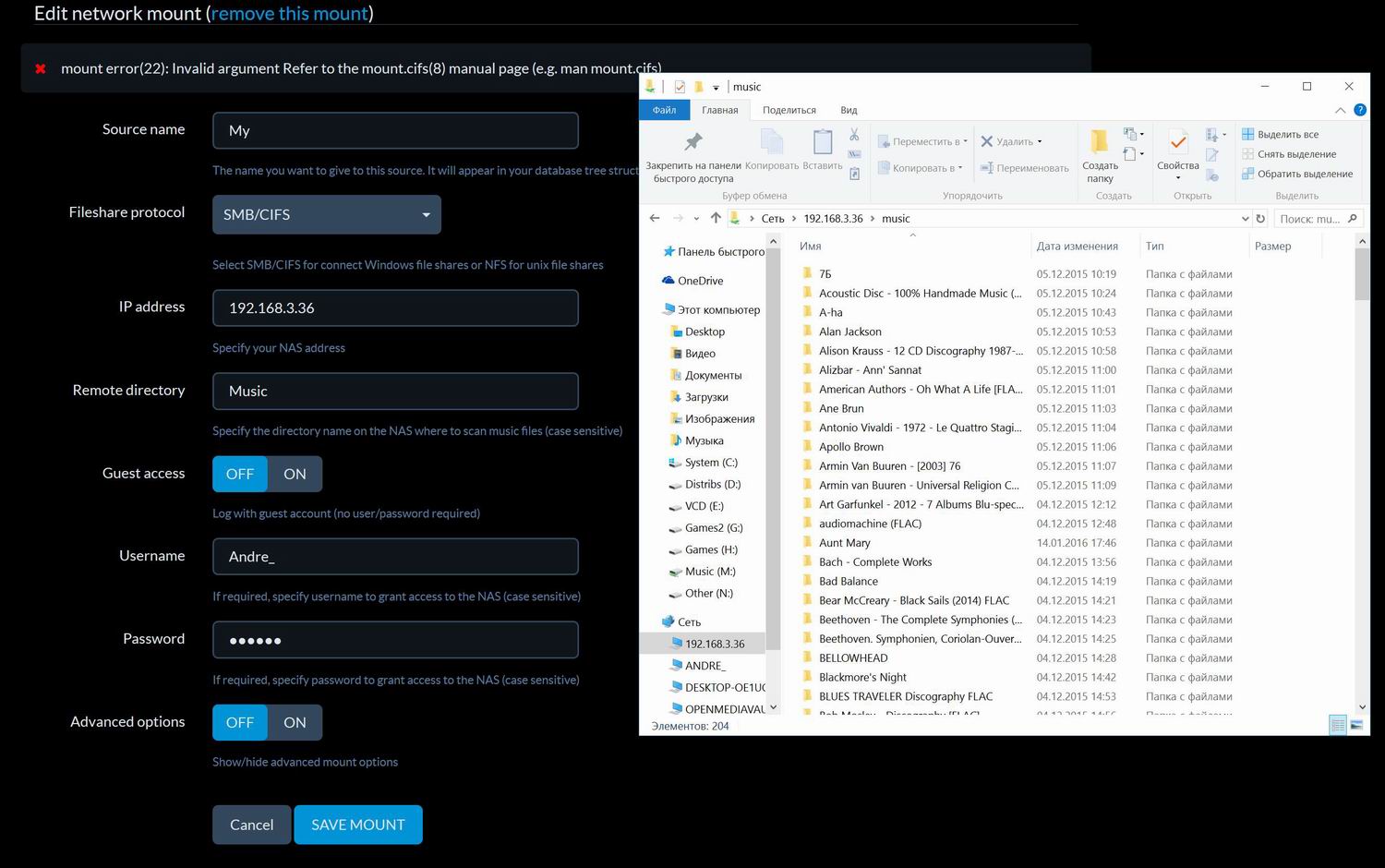

I can not mount my NAS music folder -> mount error(22): Invalid argument Refer to the mount.cifs(8) manual page (e.g. man mount.cifs)
It's fine work at windows
I changed directory name on the NAS: music, Music, Music/, music/ -- not working :(

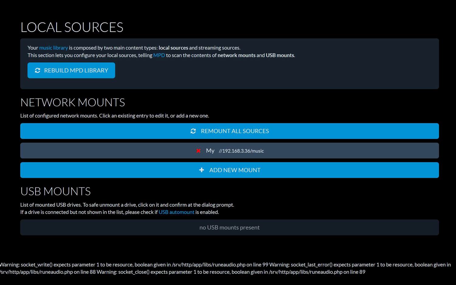

One more: Warning: socket_write() expects parameter 1 to be resource, boolean given in /srv/http/app/libs/runeaudio.php on line 99 Warning: socket_last_error() expects parameter 1 to be resource, boolean given in /srv/http/app/libs/runeaudio.php on line 88 Warning: socket_close() expects parameter 1 to be resource, boolean given in /srv/http/app/libs/runeaudio.php on line 89
Webradio work good

Hi Andre_,
your problem is the "cache=none" entry in the advanced options.

Postby Andre_ » 17 Jan 2016, 23:17
hondagx35, thx!
Started updating data base.
