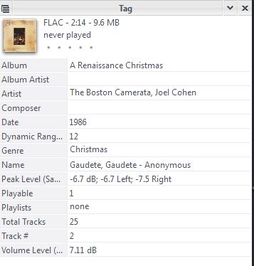

Thanks so much for the fast response, Frank. I use JRiver 21 to do my FLAC ripping and tagging, and I've attached a screenshot of the tags listed w/in that program for one of the files just as an example. I checked and the artist, album, and genre tags are listed for all of the files that I've copied onto a thumbdrive and am using w/ Rune. Do you still think it's a tagging issue? Does the directory structure on the thumbdrive matter? I've got it setup collection/artist/album/file.flac, i.e., drive letter:/Christmas Flac/Boston Camerata, Joel Cohen/A Renaissance Christmas/Gaudete, Gaudete - Anonymous.FLAC for the file listed in the tag snip pic.
On a probably related topic, when I choose a specific album folder to add to my cue, the tracks play back in alphabetical order rather than in the original playback order of the ripped CD. Again, I've verified that the track # is included in the tags. How can I get Rune to playback the albums in original track order?

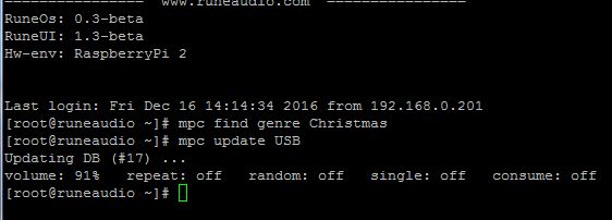

Thanks, Frank. I tried your suggestions, and here's the returns I got:
The first command, mpc find genre Christmas, didn't seem to do anything. The mpc update USB command returned a few pieces of information, but didn't make any difference in terms of the library listings. Here's a paste of my system status, in case that's helpful..

Re: MPD Library listings?

OK, an update.. the drive that wasn't indexing was FAT32. I tried mounting a much larger 128gb ntfs thumbdrive (that I was using in my second RunePi in another stereo) on the Pi we've discussing. It mounted and index w/out any issues, and there's a mix of .mp3 and flac flies on it. I figured, "Ah HA!," and reformatted the other drive to NTFS, then dragged the files (my newly ripped Christmas CD flacs) back onto it. Mounted it. Nothing.. same problem. Sigh. Then, back on my laptop, I dragged a couple of the albums that were indexing fine on the other drive over onto the drive w/ my Christmas files that won't index, then remounted it on the PI. The files that succesfully indexed on the other drive DID index on this one, too, no problem.
OK... then I tried the reverse, moving one of the Christmas albums that wouldn't index on the new drive to the old larger drive, then remounting in the PI. That album was playable via the "USB Drive," but didn't index.
SOooo.. You're right, of course. The problem must be in the files or tags themselves. I don't get it, though; I've ripped every CD I have using the same software, JRiver MC21. I used to rip to 320kb .mp3, but have been using FLAC for the past year and moving everythign over to flac files. The only ones that don't work are the 15 or so Christmas CDs I ripped a few days ago, although they play back fine both on the Pi and on my laptop, and the tags LOOK OK when viewed w/ JRiver, as you saw.
I'll have to compare some files side by side and see if I can find any differences. Do you, or anyone else, have any idea what I should look for?
Again, major thank yous to you.
Barry
EDIT - additional info in case this help anyone else. I found the issue; the albums of flac files that won't index all have an almost empty vorbis comment block; it contains "vendor = S" and that's it. All of my flacs that do index have a lot of information and tags stored in the comment block. SOoo... now I just have to figure out why my ripping software has stopped creating those comment blocks correctly, and/or how to add the info myself. Anyone? Mr. Bueller?

The problem was indeed caused by the lack of information in the vorbis comment block. The issue was solved by going back into the program I used to do the ripping (JRiver MC21), selecting each album, and using the "update tags from library" function buried in the library tools menu. When I did that, the tags that existed migrated into the vorbis comment block. I then transfered all of the files back to the thumbdrive, mounted it in the Pi, and bingo.. they're all MPD-sorted by genre, artist, or album... and the cover art displays, too!
