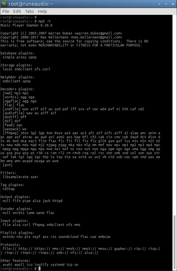

Postby R101 » 30 Oct 2017, 11:35
mpd -V output

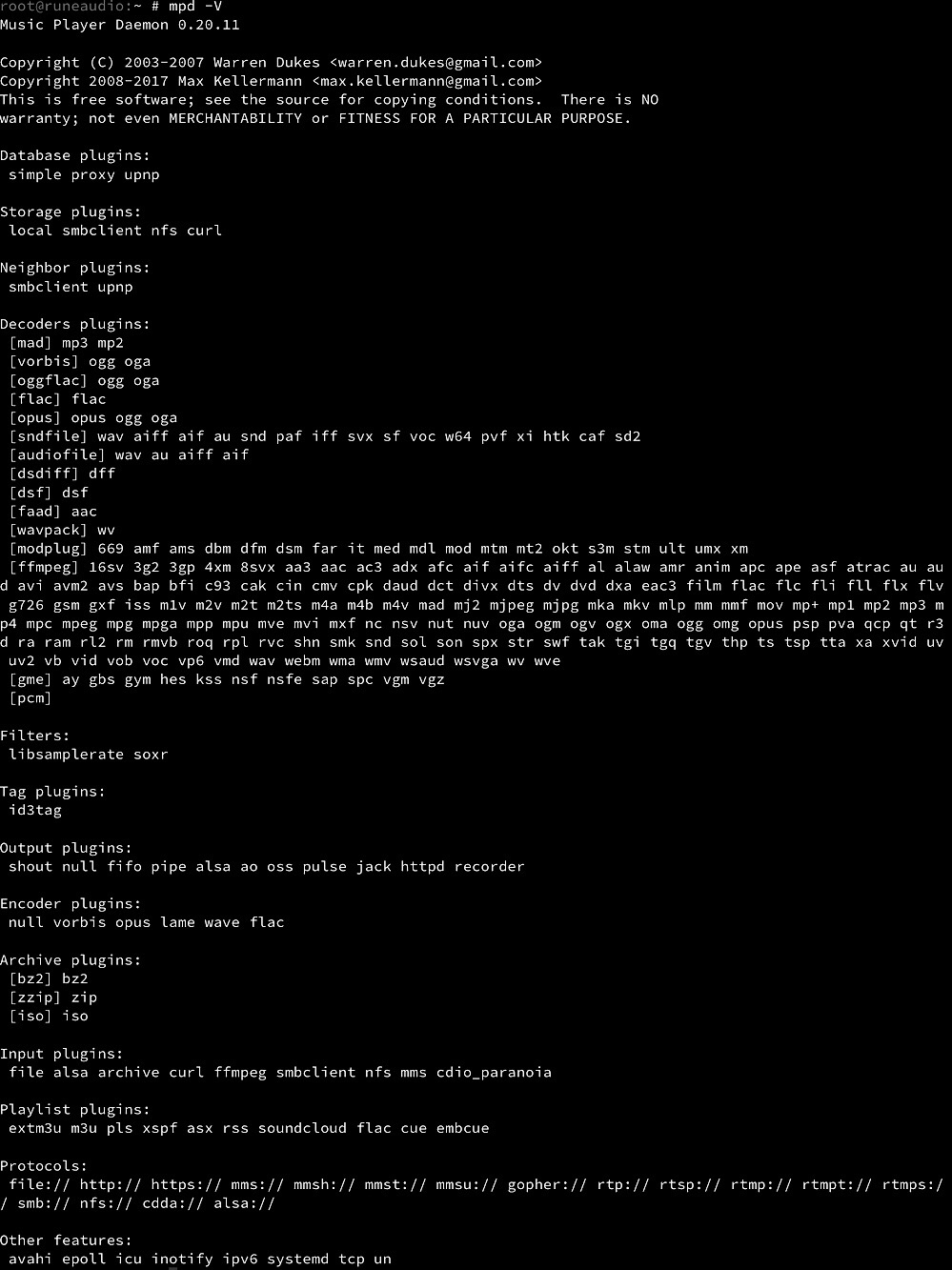

@R101,
Your upgraded MPD is 0.20.6 but the latest version from is 0.20.11.
This is my mpd -V
It's could be the mirror package server you installed/downloaded MPD from was not up to date.
Try Rank Mirror Package Servers then reinstall.

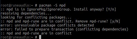

Postby R101 » 31 Oct 2017, 11:39
rern,
I have ranked the servers but this is what I get if I try to upgrade:
Update MPD.jpg (17.63 KiB) Viewed 2704 times
I am reluctant to change the default responses without knowing what I am doing.
Thanks.
