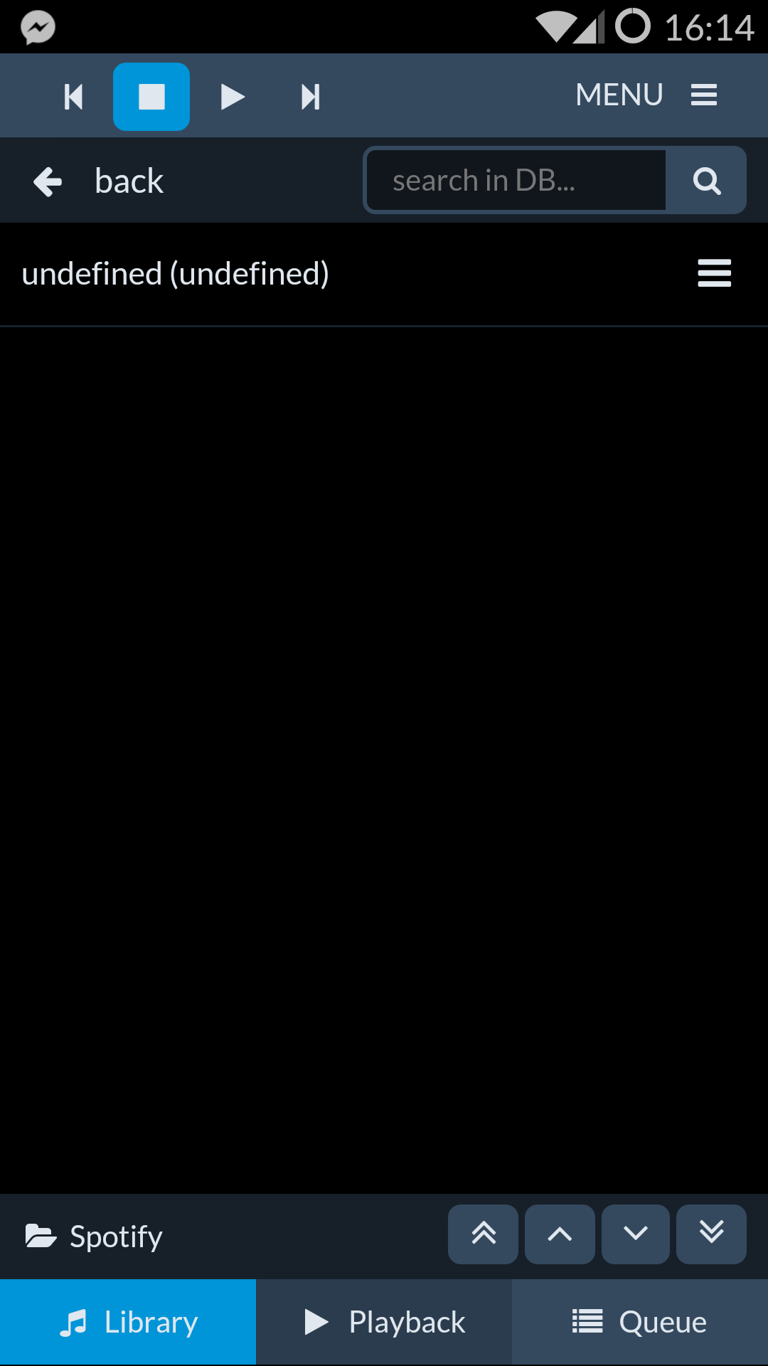

Here is my report (I'm using a RPi B+ with Hifiberry DAC+) :
- It's sad that we can't navigate through albums and artists with RuneAudio, but I read somewhere that you already know that and can't do better by now because of Spotify
- I'm using a Hifiberry Dacplus and after each reboot, I gotta go to the options to set it back to default. Isn't there any way to fix it by ourselves before the next patch gets out ?
- Plus, kinda linked to the previous one, my Spotify list of playlists is empty (when I click on Spotify under "Library", it loads the page but shows a single empty playlist called "Undefined") after each reboot, and the playlists only appear after I fixed the Audio Output thing (see previous point).
- I just can't use usb-key. When I plug it on, it gets recognized on web interface, but when I click on it under Libraby, nothing happens. I tried to format it with Gparted as Fat32, tried to put FLAC and MP3 aswell, even on the root, nothing used to work.
- I can't set a static ip adress, but this issue was already reported ; I used the MAC adress thing to have the same IP at each boot.
I know some issues were already reported, but as I had multiple one, I posted them all here. Hope you can fix it soon, or maybe tell me some way to do it by myself.

Postby Aleverz » 18 Jan 2015, 14:13
Thanks to you both for answers !
I've been deeply happy to discover that "dev mode" fixed everything I complained about ! So I hope this patchnote to be deployed soon ! ;)
There is just a thing that remains "unfixed" : when I go to the Library and try to access the Album section (or Artist, or Genre), it asks me to choose between multiple things like Spotify, MPD, etc. and when I click on "Spotify", nothing happens.
Keep up the good work ! :mrgreen:

Postby Aleverz » 18 Jan 2015, 16:25
Okay ! Btw I tried again to stop the rpi, put the electrical cable off and on back, and on the next boot DACplus was still used by default but the Spotify playlist was Undefined (see attachment). I tried to rebuild the sources but nothing changed, so I tried to switch Audio output option back to Analogue and then DACplus, and it worked : my playlists were back on. Weird...

Postby kaczor189 » 18 Jan 2017, 12:46
I have the same problem with Sportify. Login and password are corrent, I have music in Spotify Playlist, but when I choose spotify in rune there appears folder "undefined". If I change audio output in rune nothing happens and I still have undefined folder. Please help.
kaczor189
Joined: 27 Oct 2016, 08:03
Re: [SOLVED] My report about issues after a reboot
Postby ianhaynes » 18 Jan 2017, 13:10
I get that too when I first switch to Spotify and it takes about a minute for the playlists to appear. There's the same delay when launching the Spotify app itself.
