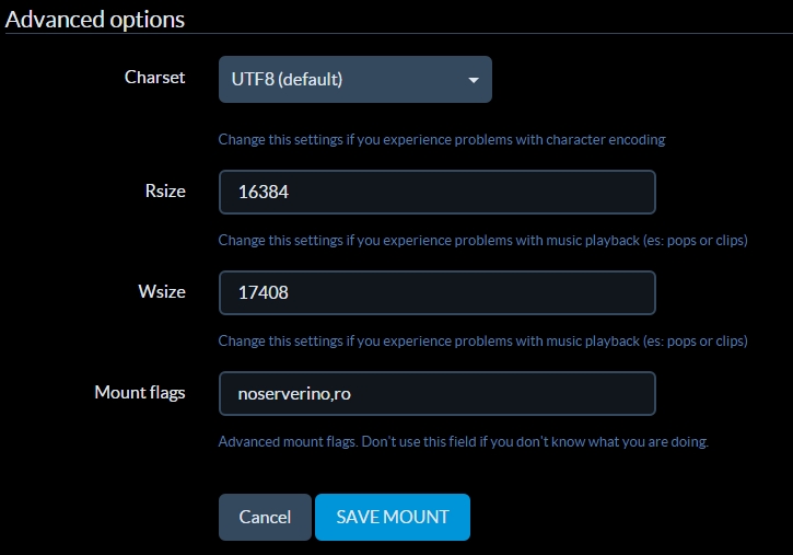

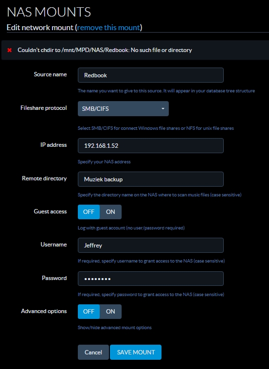

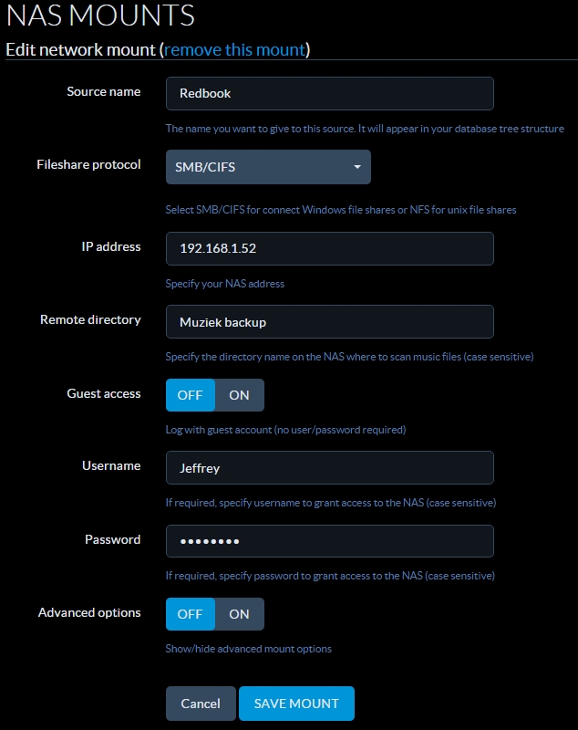

I have a problem mounting my pc network drives booting from nand. SD is fine. I get an error: Couldn't chdir to /mnt/MPD/NAS/Redbook: No such file or directory
Playing with the advance setting doesn't help either
With SD no problem:

Postby hondagx35 » 14 Oct 2015, 22:37
Re: Now officially supported Cubietruck (Cubieboard3)
Postby JeffD » 16 Oct 2015, 08:10
That did the job Frank!
Thank you!
Regards Jeff
