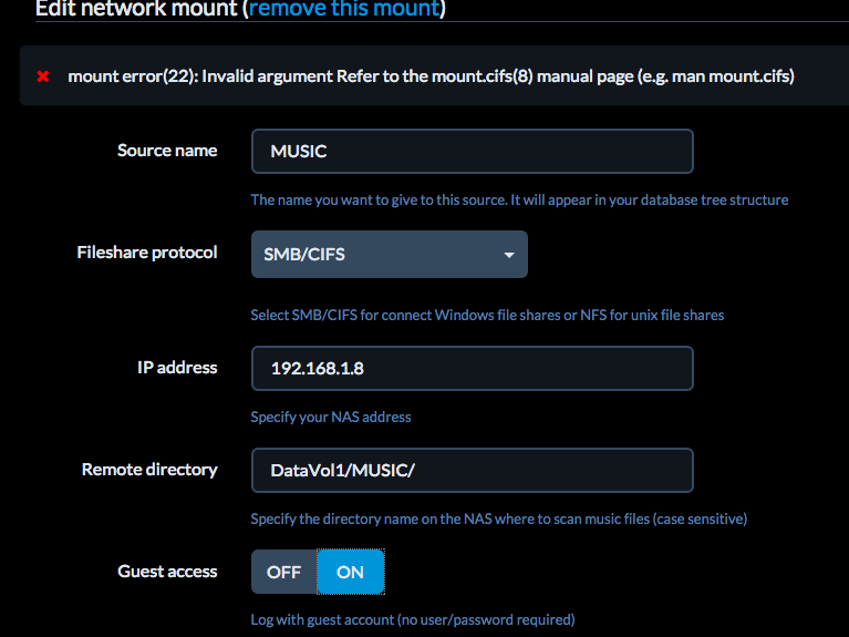

only issue im having is not being able to mount my NAS. I have both LCH Buffalo and QNAP wichich both im not able to mount.
if anyone has succesfuul mounting plaese share your info how you did it
much appreciated, thanks again
kai

Postby kajica » 01 May 2015, 21:19
NAS MOUNT SOURCES
Screen Shot 2015-05-02 at 4.00.14 am.png (83.52 KiB) Viewed 15418 times

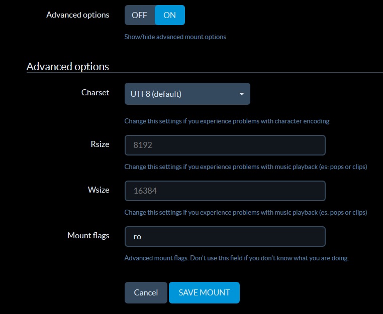

Postby hondagx35 » 01 May 2015, 22:16
Hi kajica,
please try to change the mount options like this
The problem may be the option
cache=none
SOLVED (no chache was the problem)
