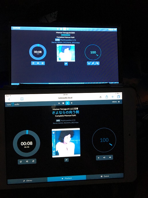

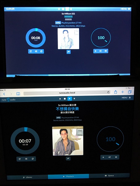

Following founding:
1. update boot.ini let my Waveshare 7" IPS display correct. But touch function still not works well
2. use iPad to control, Chinese and Japanese display well while WaveShare display incorrect
檔案 19-5-2016 21 10 52.jpeg (113.97 KiB) Viewed 3763 times
檔案 19-5-2016 21 10 33.jpeg (76.59 KiB) Viewed 3763 times

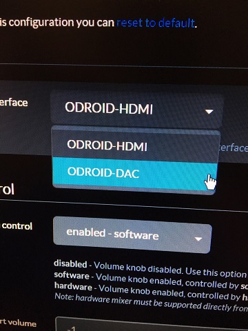

3. Enable I2S kernal, but MDP ODROID DAC option cannot be found as before
檔案 3-4-2016 06 51 59s.jpg (67.09 KiB) Viewed 3763 times
