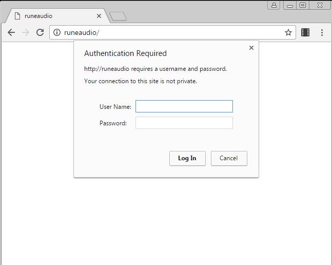

I followed the instructions, seems to work somehow, but now i can't access the runeui at all.
There is no login window popping up, just the browser saying that it cannot connect to that specific ip.
I just saw that nginx brings up an error message "nginx: [emerg] unknown directive "auth_basic" in /etc/nginx/nginx.conf:43"
Any idea? I double checked the lines being written exactly as mentioned and being at the right position...

The question about the webserver not being reachable with the .htaccess active, is still of interest.
