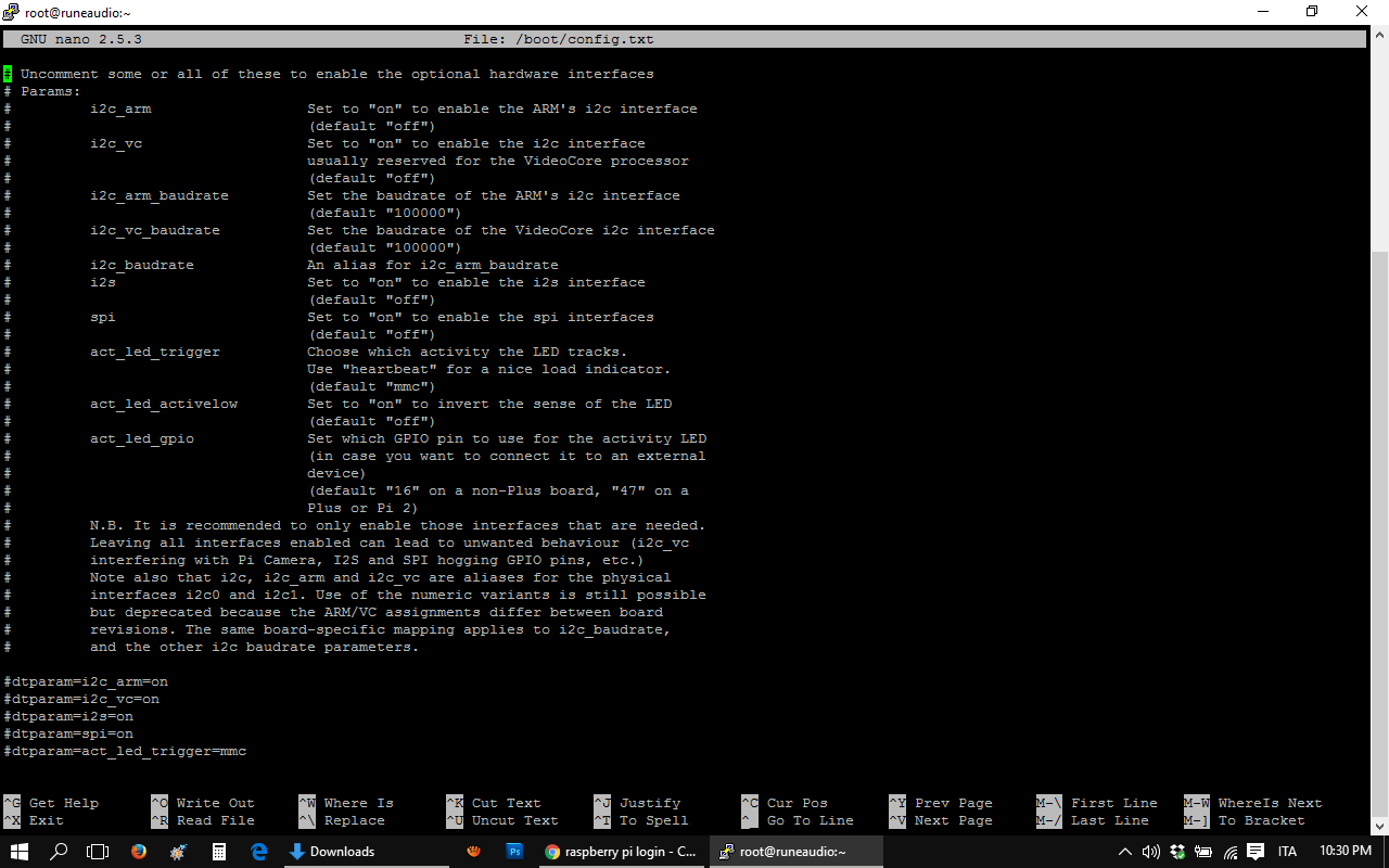

I don't know if this is the file you were referring to, but this is all what I've found with your hint.
Screenshot 2016-05-24 22.30.17.png (65.16 KiB) Viewed 19988 times

Postby hondagx35 » 24 May 2016, 22:03
Re: Pifi Dac+ V2.0 NOT WORKING on Rspberry Pi 3
Postby chighemezu » 25 May 2016, 07:26
Great, it works really well. Thanks for the support. Very professionals!
