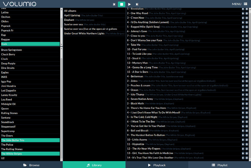

By the way I wanted to share also some work I've done on browsing / playlist management ; I am not (yet?) using RuneAudio, I'm still on the older "Raspify" on top of which I've copied-pasted the Volumio Web-UI (tried the same with RuneUI, but it didn't work, I guess it's related to the changes in linux distro ; I'll upgrade my rasp.pi one day...) ; anyway feel free to checkout my work if you find it interesting, it should be quite easy to integrate in RuneUI, and it's on github (my own WebUI fork, which is itself based on your own work if I've understood everything : https://github.com/jotak/Volumio-WebUI/ ... ct_library ) Cf. screenshot attached.
The work is still under progress, not yet functional.
The idea is to show a multi-pane filtering view to allow combined filters (by genre, artist and album) and multiple-selection filters.
Here again the performance hit of displaying very large DOM may happen for large music libraries (it's ok with my thousands of files).
