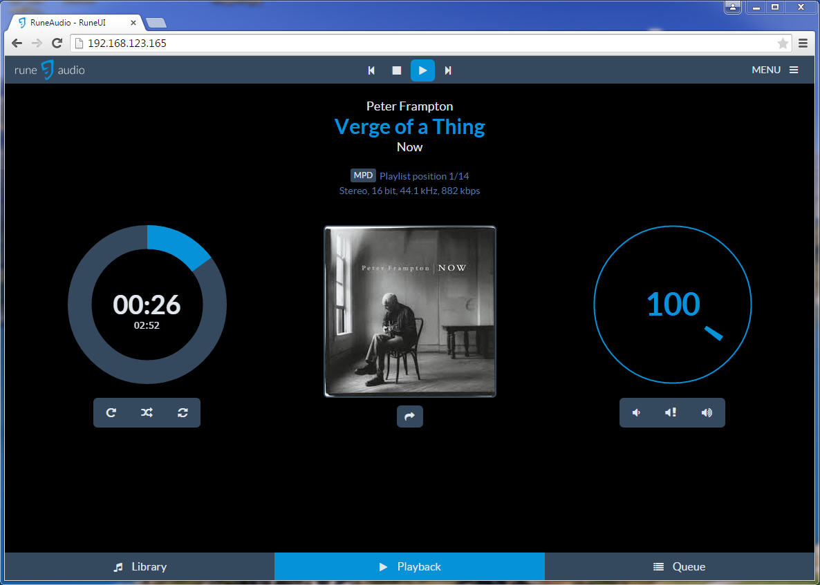

Postby gkkpch » 21 May 2015, 18:03
Checked all config files, added some I forgot.
Fixed an avahi-daemon problem, now mpd, mpdscribble, mpc all seem to work ok.
Rebuilding phpredis-rune did not make any difference, now starting to rebuild php-rune.
See if that helps.
Odroid-C1+, 8Gb eMMC, 8Gb µSD with 32bit/384Khz Odroid-C1+ HiFi shield (PCM5102)
Odroid-C1, 8Gb µSD with DAC: XMOS 384K/32bit USB (PCM5102)
Other: 24bit/192Khz Audiophonics DAC Sabre ES9023 I2S
gkkpch
Posts: 64
Joined: 19 May 2015, 11:58
Location: Switzerland
Re: Port Runeaudio to Odroid X2 (Arm v7)
Postby gkkpch » 21 May 2015, 19:58
light at the end of the tunnel :D :D :D :D :D :D
The main problem were
- mpd needed to be re-complied because of dependencies
- avahi-daemon was not working because of "SO_REUSEPORT failed: Protocol not available", fixed in avahi-daemon.conf
- php.ini: redis.so was missing as an extension.
There are a number of open issues, like Dirble just spins, dsd/ dsf tracks are not working. This needs to be looked into.
The whole procedure needs to be re-done anyway to get a clean "cookbook".
This was a good exercise and I learned a lot.
