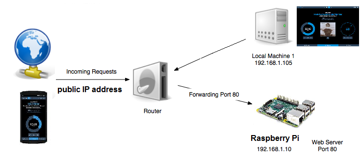

Postby hondagx35 » 31 Mar 2016, 22:30
Hi dror,
to get your RuneAudio puplic available you have to do:
- change your network profile to statis IP address
- go to your routers config page
- forward port 80 to your PI (static IP address)
- search for your public IP address 1)
- open your mobile browser
- navigate to
http://your-public-IP
- enjoy your public available RuneAudio
1) you can use something like to get a fixed URL for your network (so called "Dynamic DNS")
Further readings:
https://en.wikipedia.org/wiki/Port_forwarding
http://www.noip.com/support/knowledgeba ... ing-guide/
WARNING: From here your Pi is available for everyone who finds out your public IP!
