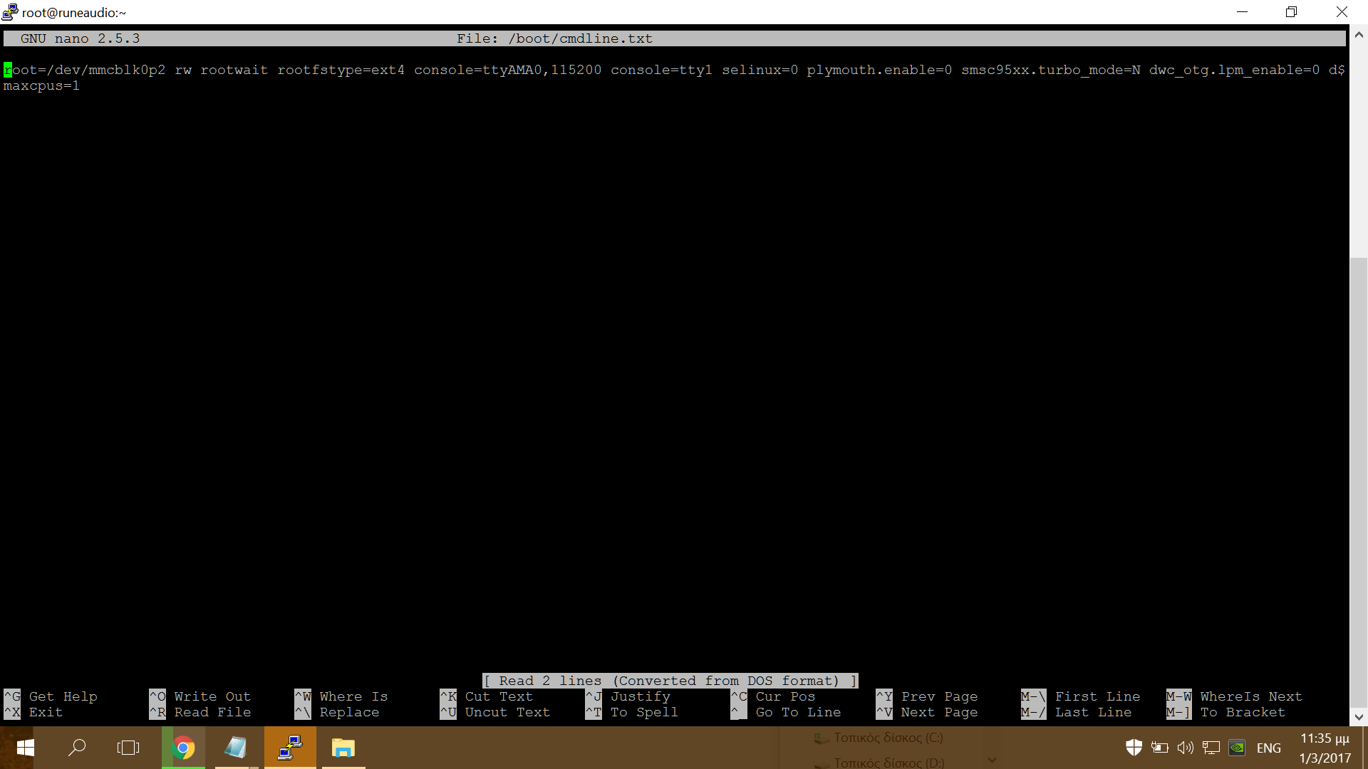

Postby nickvas19 » 01 Mar 2017, 22:35
i put 2 pics to tell me if i make a mistake somewhere.sorry is my first steps.
i started from # uncomment to overclock the arm"
Στιγμιότυπο οθόνης (3).png (108.49 KiB) Viewed 1525 times

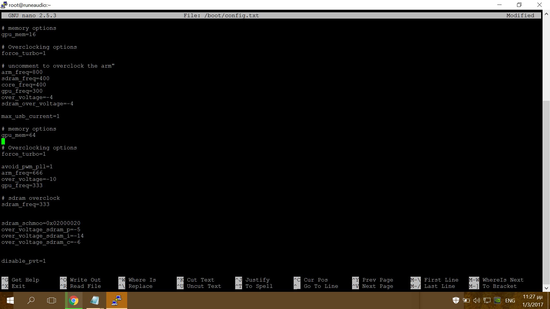

Postby nickvas19 » 01 Mar 2017, 22:36
and the second...
Στιγμιότυπο οθόνης (4).png (57.7 KiB) Viewed 1524 times

Postby nickvas19 » 02 Mar 2017, 12:50
well in detail my steps.
audio output: ifi (by Amr)
volume control:disable
dsd: enabled
soundsignature : Archlinux default
airplay:off
local browser:off
aply reboot
after this i go to sudo nano /etc/modprobe.d/disable_rpi3_wifi_bt.conf and i put these
##wifi
blacklist brcmfmac
blacklist brcmutil
##bt
#blacklist btbcm
#blacklist hci_uart
systemctl disable netctl-auto@wlan0
also in nano /boot/cmdline.txt i leave everything as it is but i write before the quiet this all in one line.
dwc_otg.microframe_schedule=0 dwc_otg.nak_holdoff_enable=1 dwc_otg.fiq_fix_enable=0 smsc95xx.turbo_mode=N dwc_otg.lpm_enable=0 maxcpus=1 quiet
and in sudo nano /boot/config.txt i change the folllowing
gpu_mem=64 to 16
and in the end of all this logs i write the following
disable_pvt=1
avoid_pwm_pll=1
arm_freq=666
sdram_freq=333
core_freq=333
gpu_freq=300
over_voltage=-10
sdram_schmoo=0x02000020
over_voltage_sdram_p=-5
over_voltage_sdram_i=-14
over_voltage_sdram_c=-6
so i wll wait to tell if i am right i these modifications. thanx a lot in advanced

Postby Discovery » 02 Mar 2017, 15:07
Hi nickvas19,
Let's assume you've made the entries correctly - does RuneAudio still work? This is always the best test!
