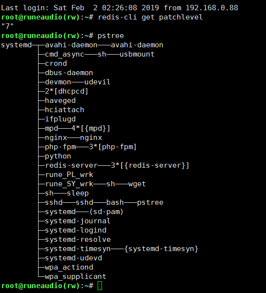

Postby andre_chang » 02 Feb 2019, 07:27
Hi janui:
After I get pull again, I turn it on for about 25-30 seconds. It's normal!
SETTINGS - > Local browser doesn't work after getpull! When opened - > Storage - > Refresh - > is still closed!
But turn off - poweroff & reboot on browsers doesn't work at all.
I try to reboot from SSH in the background and reboot can be restarted very quickly. Type shutdown doesn't work. Suddeo halt is necessary!
Andre

Postby janui » 02 Feb 2019, 19:22
Hi andre_chang,
Thanks again for the great diagnostics. I have looked at the code and done some experimenting without an internet connection. I think I have found a bug. This causes problems only under very specific circumstances, most users would not notice it. Could you do another git pull (preferably via the /dev UI) and try again?

Postby andre_chang » 03 Feb 2019, 17:39

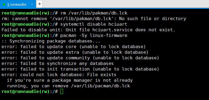

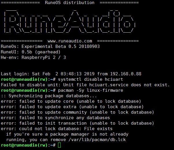

Hi janui:
I've added it to / boot / config. txt
Dtoverlay = pi3-disable-wifi
Dtoverlay = pi3-disable-bt
And run the following command via SSH:
System CTL disable hciuart < -- Failure

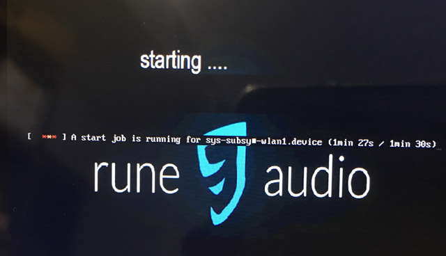

In addition, when WiFi key is inserted, some errors will appear in the boot screen.
A start job is running for sys-subsy-wlan1.devices..
Even if the WiFi key is removed... only the pi3b + & SD card + LAN is left unplugged, there will be these errors in the boot process... I feel that this error is related to the function of Access Point (AP),
I suggest removing the function of Access Point (AP). It can easily cause many unnecessary errors. Of course, it may be that I don't understand it.

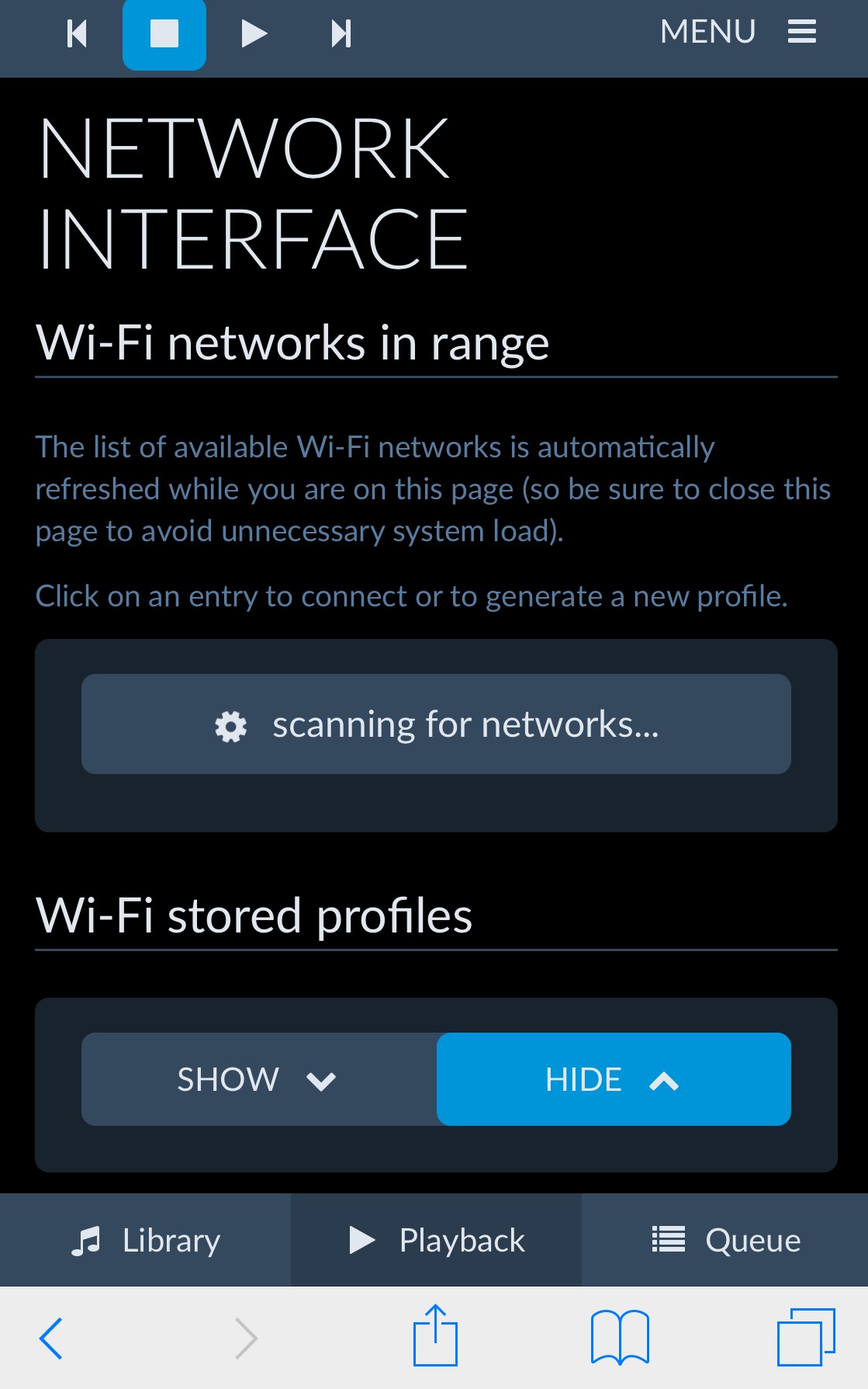

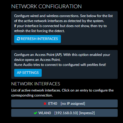

Hi janui:
First to test connection to yor WiFi...
Remove the EDUP EP-MS1558 300M dongle. I assume that'closed Access Point'means your WiFi has a hidden SysID. This means that your WiFi name will not be displayed in the list of'Wi-Fi networks in range'. To connect:
1. Disable the AP: Menu > Network > AP SETTINGS > Set Access Point OFF > SAVE AND APPLY
2. Add your hidden WiFi Network: Menu > Network > WLAN 0 > SHOW > ADD NEW PROFILE > fill in your details > SAVE PROFILE and Reboot
You should get a WiFi connection after rebooting.
Has been connected successfully!!!
But I still can't succeed. I'm sorry that my network environment has disappointed you. (~>_<~)
A start job is runing for sys-subsy-wlan 1.device < - Can you tell me why?
thank you...
