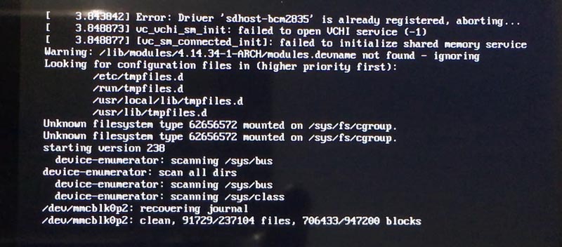

Hi janui:
Rm/var/lib/pacman/db.lck< -- This command has been run.
Although my EDUP EP-MS1558 300M dongle is working properly, I still upgrade for linux-firmware. Success. Hope to solve the problem that A start job is running for sys-subsy-wlan 1. device.. But unfortunately.. I still have to wait 1 minute and 30 seconds during boot...
I'm trying to pick up the boot process for your reference. I hope you can help me find a solution. Thank you for your help.
Andre
Boot process.jpg (84.03 KiB) Viewed 1585 times

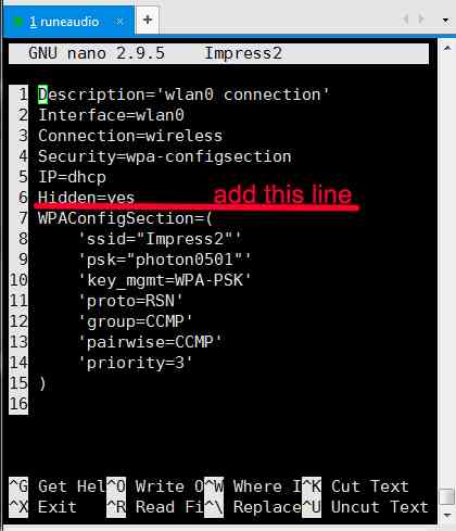

Postby andre_chang » 06 Feb 2019, 07:33
Hi janui:

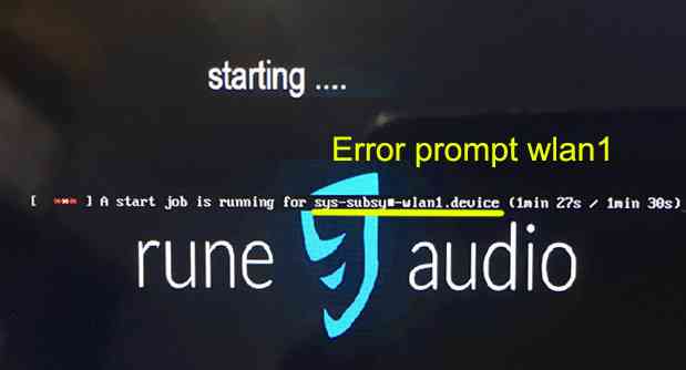

I've added it as directed by you, but there's still a screen waiting for 1 minute 30 seconds when I turn on.
This screen prompt needs to be waited for:
A start job is running for sys-subsy WLAN 1.device (1min 30s)
The display is "wlan1"

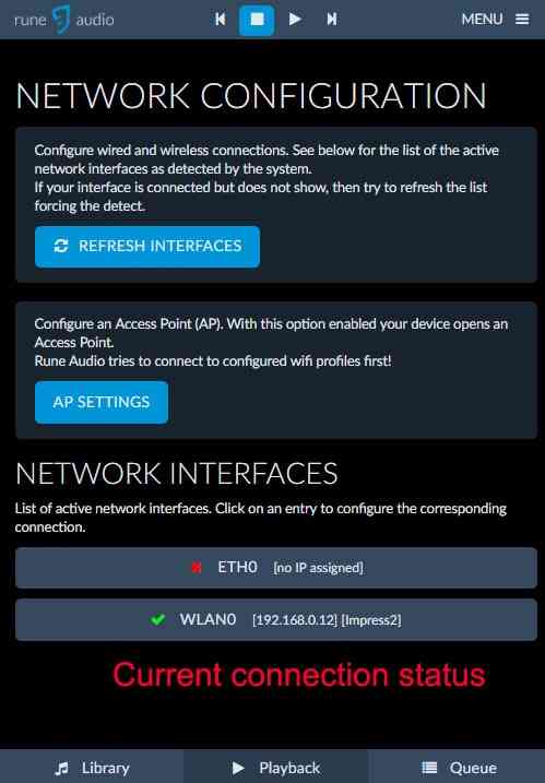

My current EDUP EP-MS1558 300M dongle shows WLAN 0<-
My
Look at my screenshot.

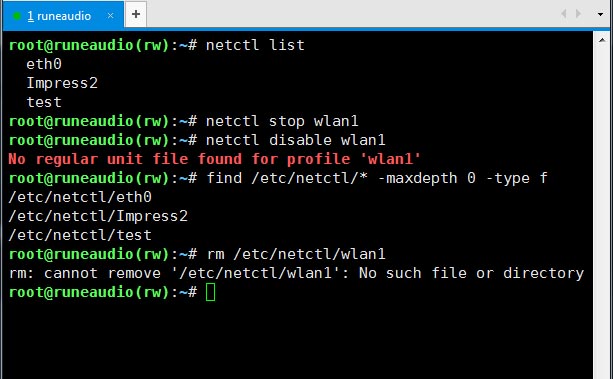

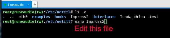

Postby janui » 06 Feb 2019, 12:23
Re: Raspberry pie 3B+
Postby andre_chang » 06 Feb 2019, 15:15
Hi janui:
It seems that wlan1 does not exist.

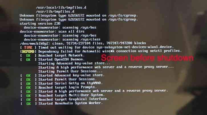

I spent 2-3 hours searching again: a start job is running for sys-subsy WLAN 1. device (1 minute 30s)...

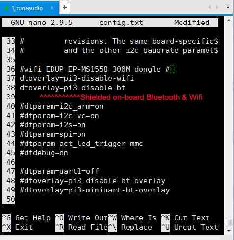

10. Disable onboard WiFi Bluetooth:
SSH logoin:
Nano/boot/config.txt
join
Dtoverlay = pi3-disable-wifi
Dtoverlay = pi3-disable-bt
Save - Exit nano...
11. Reboot: a start job is running for sys-subsy WLAN 1. device (1min 30s) problem.
