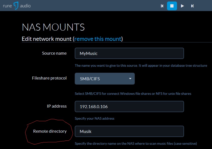

why don't you mount only that specific folder instead on the whole drive? You can specify the path in the "Remote directory" field.

Is there a way to include only specific USB mount folders (/music and /audiobooks) in the database update instead of the whole hdd? There is no configuration in the web GUI (like "Remote directory" field for Network mounts). Maybe be editing some symbolic links etc.?

Postby RockOn_23 » 07 Dec 2015, 18:57
But it only influence the NAS mount, not the USB HDD?!
