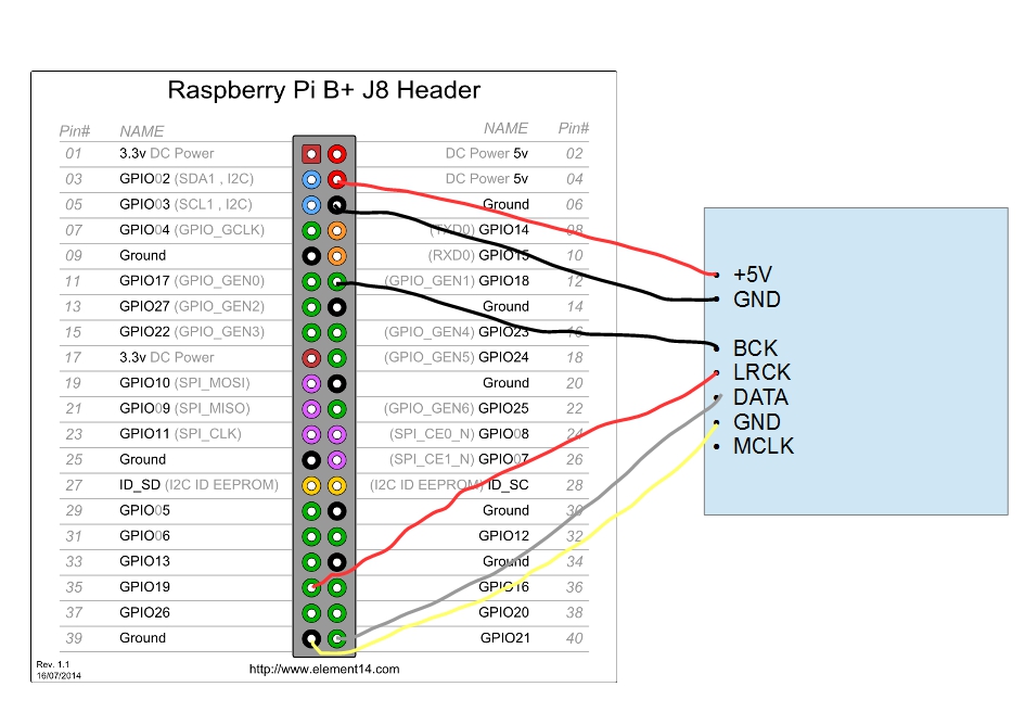

I run rune 0.3 on my Raspberry Pi 2 model B

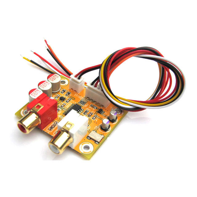

I have this DAC
I connected it this way ( It's should be the same pinouts as the B+ model )
i2s wiring_BPlusIdem2B.jpg (183.91 KiB) Viewed 2073 times
And can't get it to work... Should I see a specific audio output in the MPD configuration menu ?
Thank you very much in advance for any help

Postby hondagx35 » 11 Feb 2016, 15:40
Hi Florian,
see .
Edit /boot/config.txt and enable Hifiberry DAC.
Re: RPi 2 ES9023 (P) DAC i2S not working
Postby flodjo78 » 11 Feb 2016, 16:07
Holy S*** it sounds good !!!!
Thank you for the fast answer
