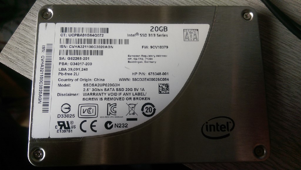

Hello people,
Just found this kicking around inside some redundant workstation computer:
20141017_152141_Android 1.jpg (148.47 KiB) Viewed 3671 times
It's a freebie, it's 20GB, and it'll hopefully outperform any manner of SD or USB pendrive I'm sure in terms of performance. I believe it's role was as a caching drive in a machine that used a conventional hard drive for the OS.
Question is how can I get runeaudio running from this? From what I've read online, the SD is still required for the bootloader. Can anyone point me to some info online on how to go about doing this? i.e. configuring and partitioning the SSD, breaking the runeaudio image apart, copying the data correctly, and directing the bootloader to it somehow. Whether it's a pointless exercise or not, just fancy doing it for fun! And if things run better from it, may integrate it into the build.
Thanks :-)

In order to connect this to a Raspberry Pi B/B+ you will have to source a suitable SATA --> USB converter cable, which can be found online for approx. 15 bucks (USD). i.e. on Amazon , (maybe somehow cheaper on other sites, haven't checked).
Not sure if it's worth the effort, though: in terms of speed, you will be limited by Raspberry's USB 2.0 ports so I doubt you would see any performance increase over a 'cheap & dirty' 32Gb or 16Gb USB key which are cheaper then the converter cable alone...
